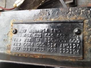

It should look something like this:
The Fender tag or Data plate is located under
the hood on top of the drivers inner fender.
This tag is from a Magnum GT - (Code A75)
Fender tag Decoded!

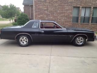

Here's my '79!
Nice looking Magnum! Sent you a PM.
Here you go...Thanks for the help!
I see you've had your fender tag posted for a few days now? Here's your codes!
Codes-Start from botton to top!
E57 - 360ci 8cyl/SD 2bbl (Ser# K-code)
D33 - A999 A/Transmission
XS22 - X=Magnum / S=Special price class / 22=2 Door special coupe
K9R - K=360ci 8cyl/SD 2bbl / 9=Year 1979 / R=Assembly Plant-Windsor, Ontario, Canada
122194 - Indicates the sequence number or serial number
TX9 - Black lower paint
C6R4 - C6=Low back Bucket Seats with Non-Recliner / R4=Red interior
000 - Door upper paint color, Not used for these cars. 000=No Paint/Full Door Panel
914 - Built on the 9th month / 14th day
AM5120 - Unknown
TX9 - Black upper paint
V3X - V3=Landau top / X=Color Black
U - Built for USA
B10 - Standard Duty Front Disc Brakes / Standard Rear Drums
000 - Unused-No special codes
28 - Large radiator
K5X - K5=Vinyl Side Body Moldings / X=Color Black
C21 - Center Front Arm Rest
C56 - Low back Bucket Seats with Non-Recliner
G52 - Standard/Round Left Outside Chrome Mirror w/Remote control
H51 - A/C with Front Heater
N37 - Catalytic ESH System
N88 - Cruise Control / Speed Control
N94 - ESA with Catalyst
END = End of codes
Any questons, just ask or PM me.

Here's my '79!
Thats a nice looking ride man! I would look for any fuses that are blown, you may get lucky.. And check around the axle tubes on your differential, you may find a band wrapped on it with some info on your rear end, Admitting im guessing but ive seen bands with info on different cars differential before, so it may be worth a look.. Good luck.
