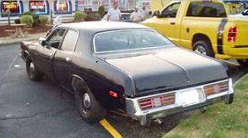

Like these?
That's the style, rarely seen these days in the northeast. Mine had a 360 big holley 2bbl torque flight with trans and power steering cooler and a 9-1/4" rear. It was heavy duty.
Welcome
I have several of these cars. They are hard to get GOOD parts for. There are about 4 different tail light lenses for these. The 75-76 Coronet, The 77-78 Fury, the 77-78 Monaco, and I believe there was an odd one for the first Fury too. They all interchange, but the the cosmetic design varies and the amber area for the turn signal is not on the 75-76. Ebay is getting worse with their constant web "enhancements". Once in a while someone parts out a Cordoba and some of the parts fit our cars, but that's becoming rare. If you have a big block/727 the parts situation is a lot worse. Dash pads and interior parts are impossible to find too.
