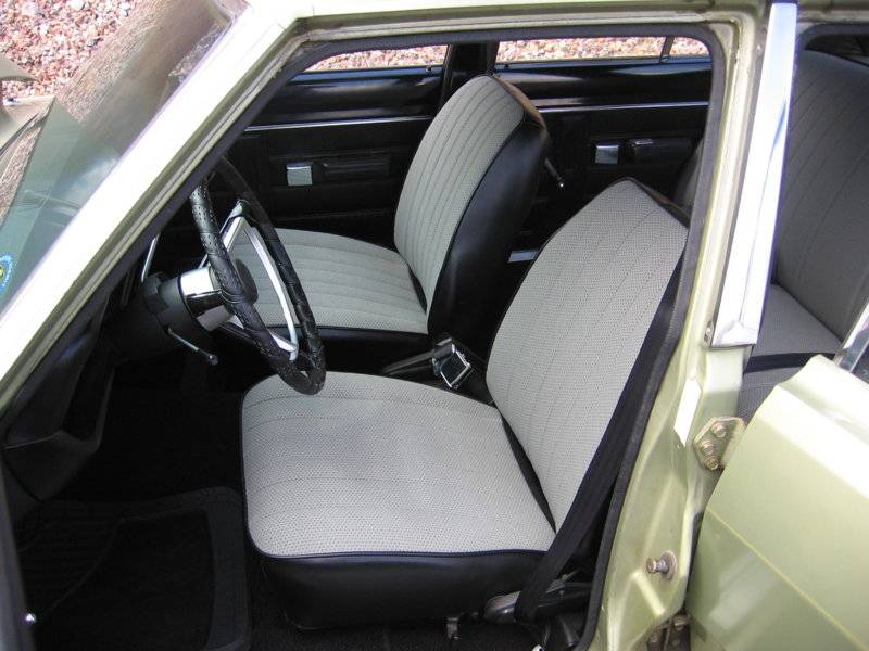

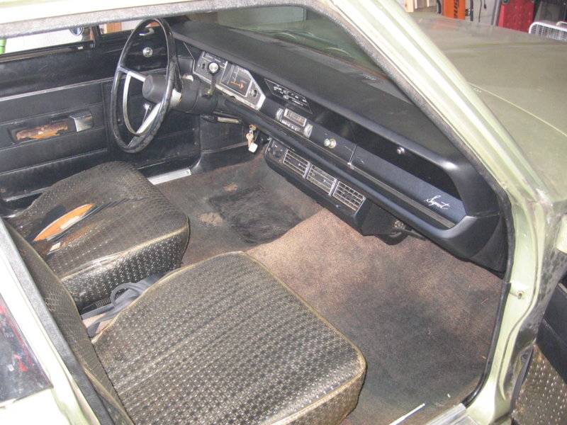

Remember at one time you could get anything from Chrysler when ordering a new car. Time and time again cars show up that were factory "they never made that"..
Here is a strange one for you.1968 Valiant factory 4 door bucket seat car. Yes it showed it on the fender tag.
Here is a strange one for you.1968 Valiant factory 4 door bucket seat car. Yes it showed it on the fender tag.View attachment 716379 View attachment 716380
