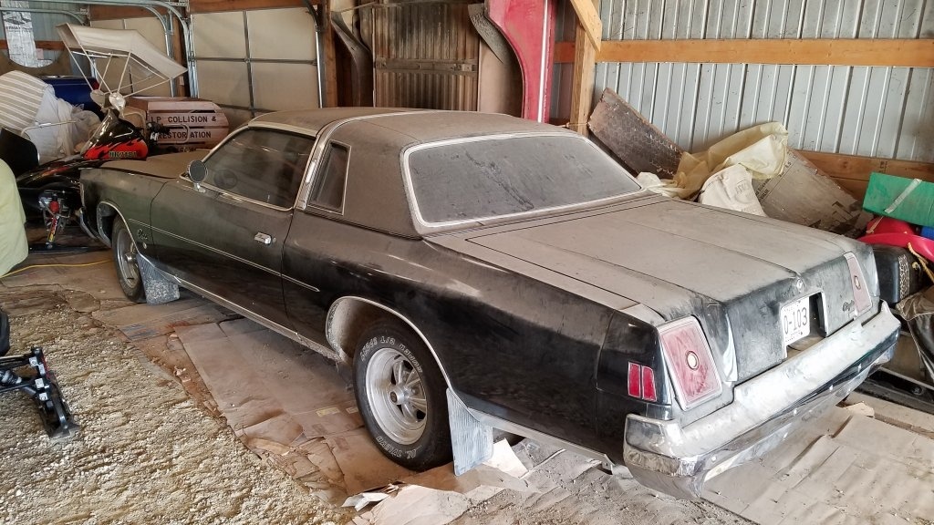

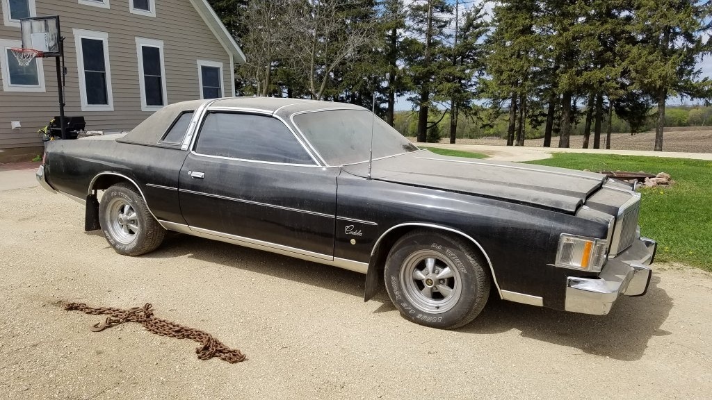

This car belongs to my uncle and he originally repainted it when he was in auto body school in 1986. Originally the car was dove gray with a red top. When he repainted it he went to a Black Metallic with a Black Top.
This has been her home for about the last 5 years. The lean burn had gotten to the point where it just didn't run good enough to take it out driving. Last fall when we tried to move it the lean burn had finally completely crapped and the car wouldn't even start.
First time in the sunshine in quite and while and she definitely needs a bath!

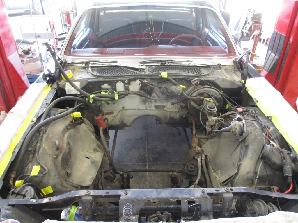

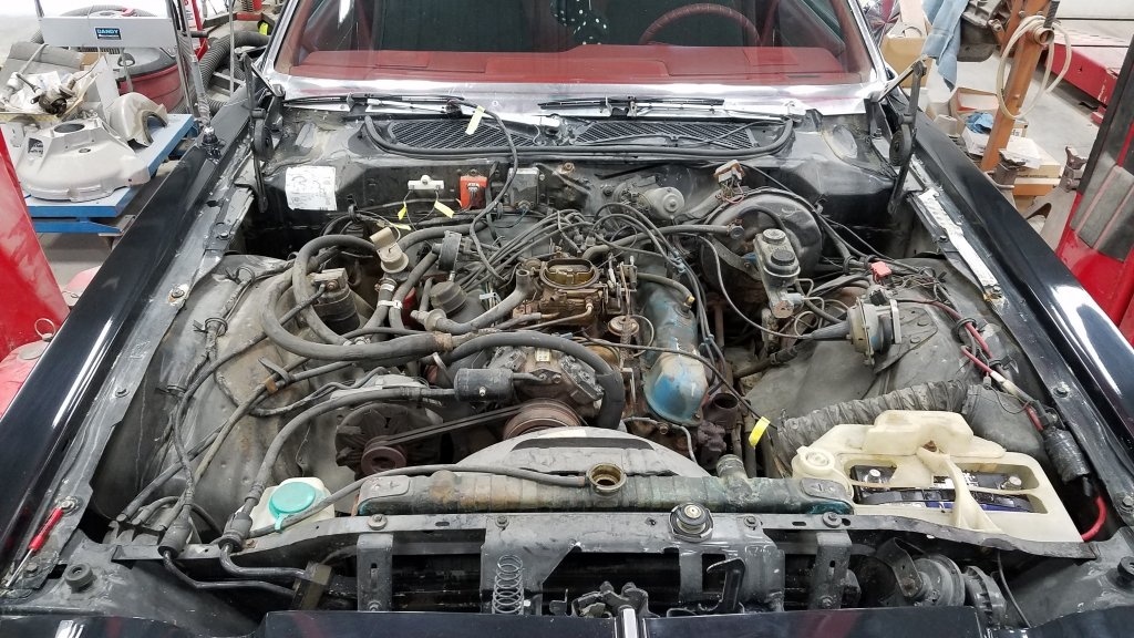

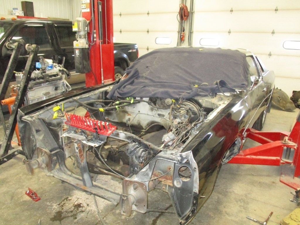

After the bath and into the shop here is the before picture... I wonder how much of this garbage I can make go away...

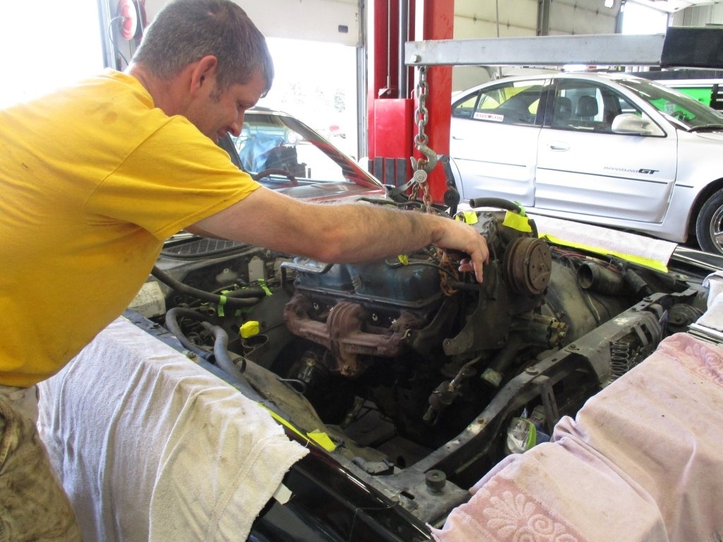

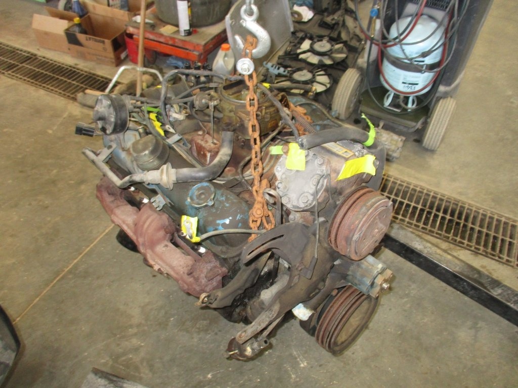

The engine is coming out!
Need to pick up the rebuilt block and start swapping out the parts that we're gonna keep...
With the engine and tranny dropped now it's time to clean, clean, clean. Don't have the picture but dropped the passenger side metal fender well, drivers side needs a little love from where it was repaired in '86 from a battery rusting through. Apparently someone thought it would be a good idea to weld it to the radiator support.
Then I'll start prepping the under hood area and most of the suspension for a fresh coat of satin black paint!

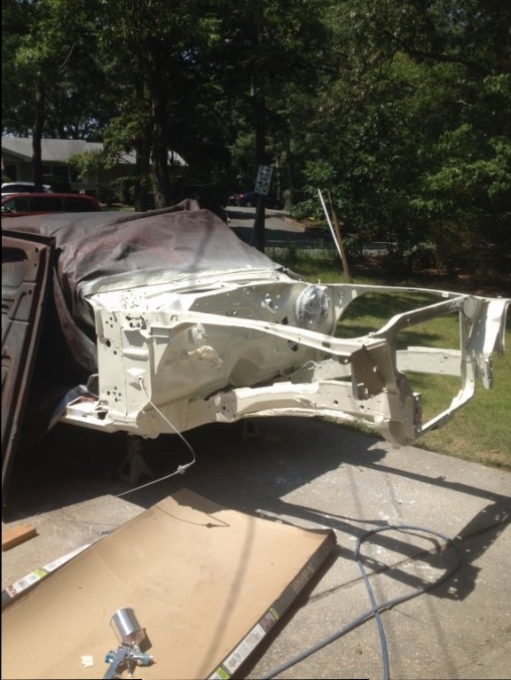

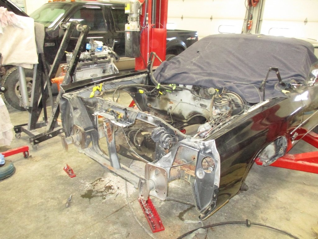

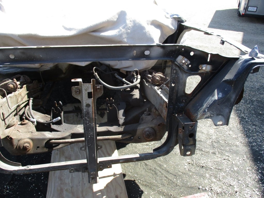

Dug into the battery tray fender liner issue today and we weren't happy with what we found.... So, off comes the entire nose of the care, it will make it much easier to fix the rust that was there and will also allow us to sandblast and prep what we need to without having to worry about damaging anything!

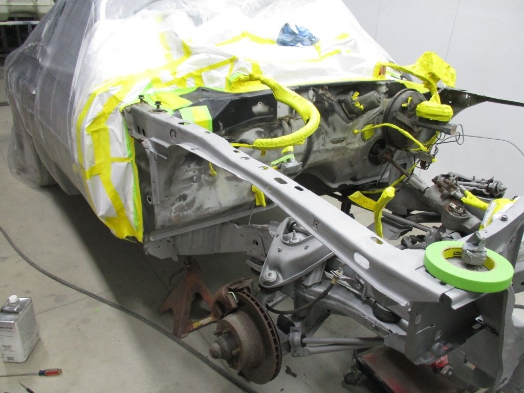

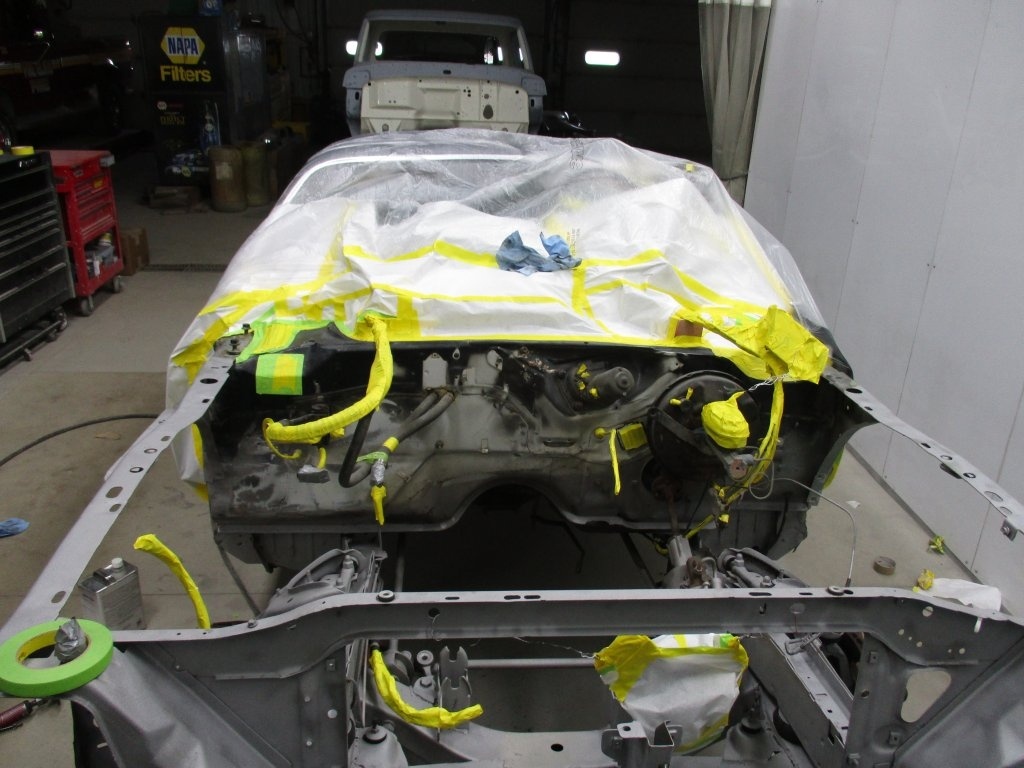

Been a long few days but here we go...

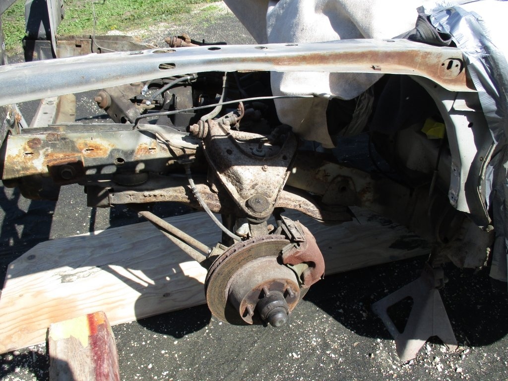

Here's the before picture, not too bad for 37 years. After '86 it never saw Winter so in reality only 7 years of rust to take off plus whatever has "grown" from moisture in storage.
Didn't take time to take a lot of before pictures. Kind of regretting that at the moment. But it was 85 degrees and I just wanted to get after it!
All told, about 6 hours of sand blasting and 12 bags of sand to do the frame, wheel liners and other parts.

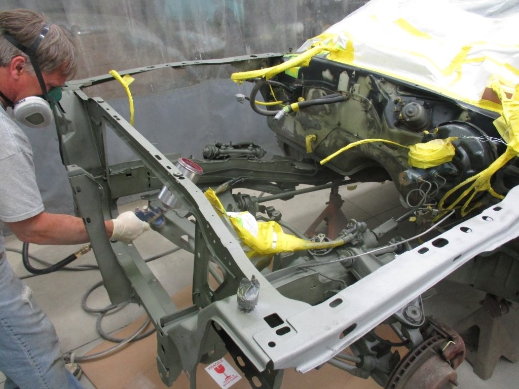

Got everything taped and bagged off. Ran the DA around everywhere I could to feather out the edges from sand blasting, took a wire wheel to the brake booster to get some flaking paint off. Cleaned the entire firewall with Fin-L-Wash and then took a scuff pad to everywhere I couldn't get the DA into.
All ready for etch priming.
I'll post more when there is something significant, but for now... Off to relax on the Harley!

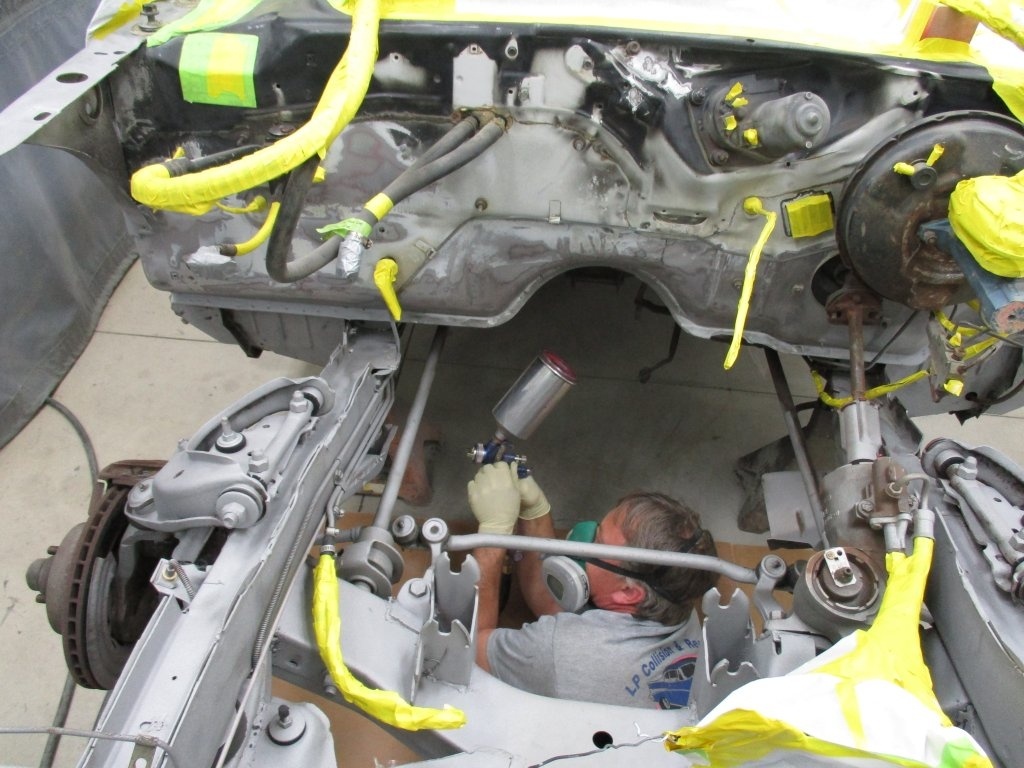

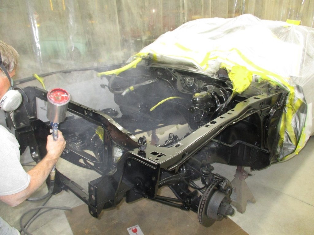

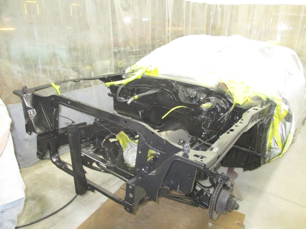

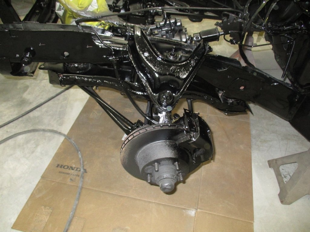

Here we go, frame and parts primed and painted today!
Just starting the etch primer.
Etch priming nearly done.
Black primer done.

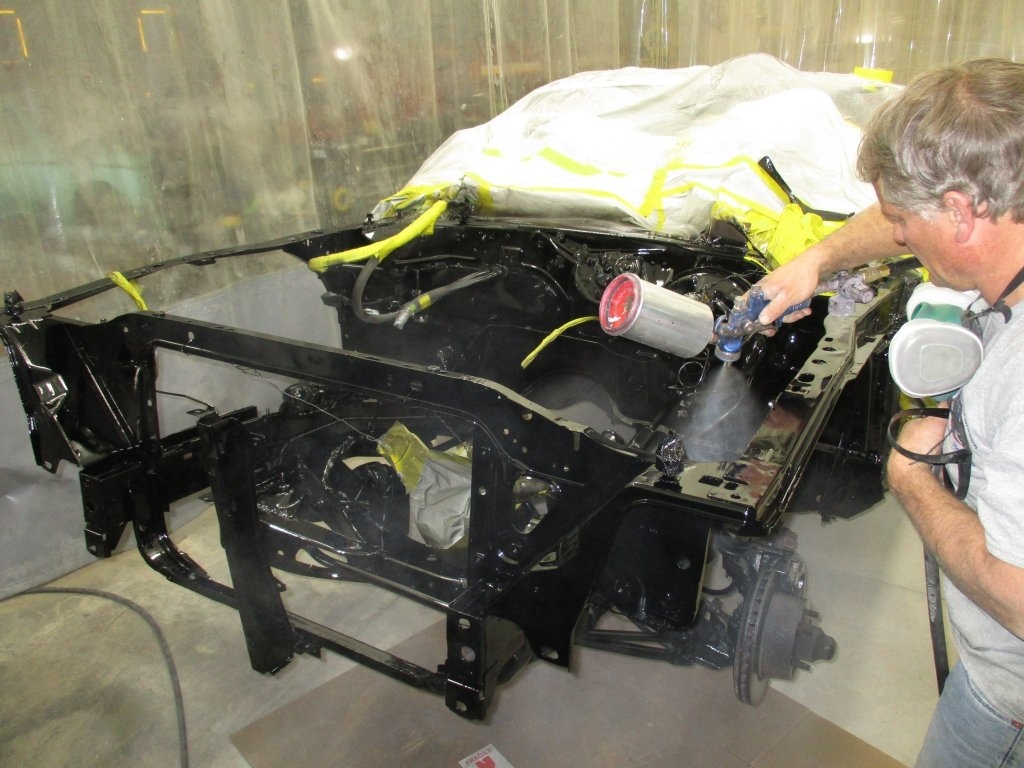

Working on the black basecoat.
Applying the clearcoat.

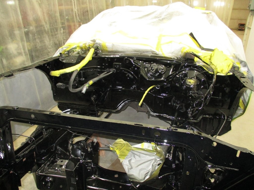

Clearcoat complete! We used a duller for everything below about midline on the firewall and then normal gloss clear for everything about that and the mounts for the fenders and the radiator support.

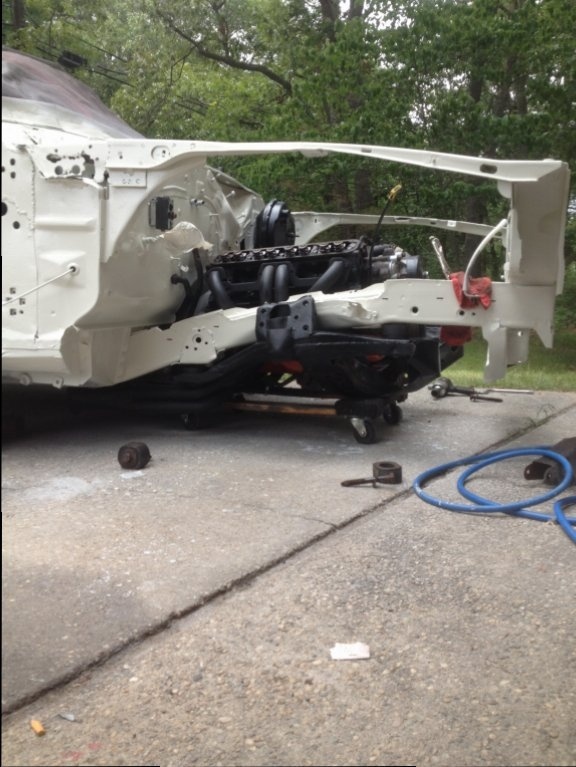

A Spiniker White, '79 Magnum, '00/5.9/727/9-1/4/3.55's,
Hooked Super Comp headers, RPM intake and 650 Thunder.
