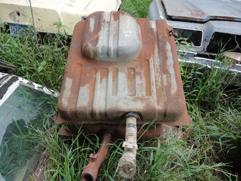

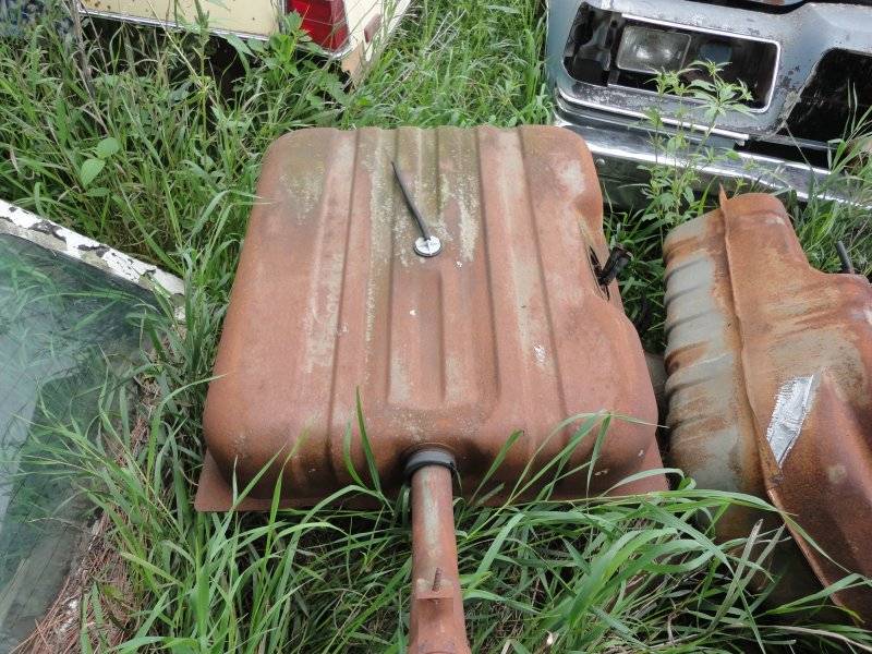

78 and earlier WILL NOT fit. you can put a 79 in an older car but the other way around. Save some time and don't bother with the 73. I'll see if I have some tanks here and get a few pictures tonight.
Sounds great, let me know what you have.
tank pictures

Not in a 79. Unless you cut a big hole in the trunk floor.
maybe it was the '74. I recall talking with a guy who stated he used a 73 or 74 Charger tank, one is humpless, one is humped like the '78's. Memory fades.
