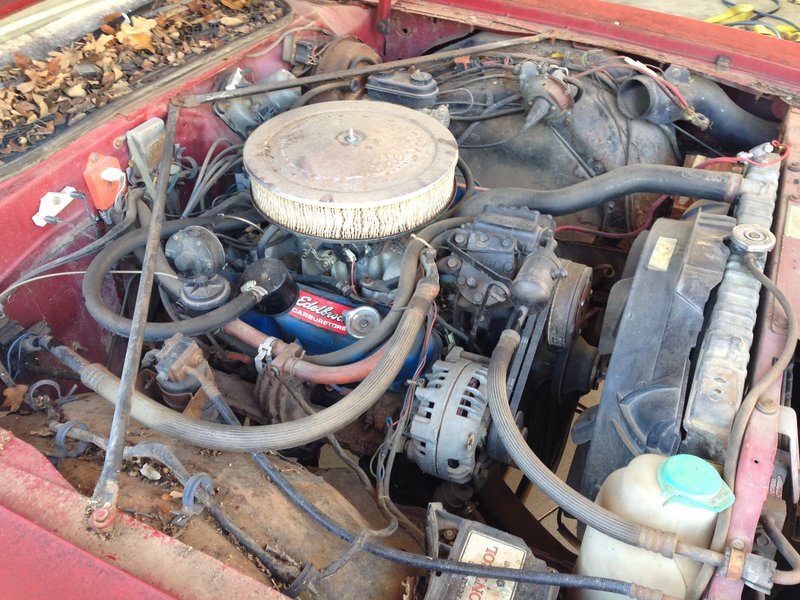

rsz_img_0654.jpgrsz_img_0652.jpgI just bought a '79 Magnum GT that has been sitting for over 10 years. It has a 360. I did get it running after cleaning out the gas tank and lines. I can't find a source for the filler tube grommet or the sending unit. Would a grommet or sender from another model work? I thought about soaking the old grommet in trans fluid so it swells up and re-seals, but would rather have a new one.
Also when the headlights and key are on, there is a buzzer that stays on. The buzzer is towards the top of the dash left of the column. I also don't have dash lights with the headlights on, don't know if that's related.

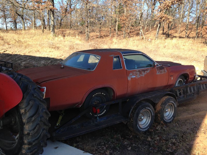

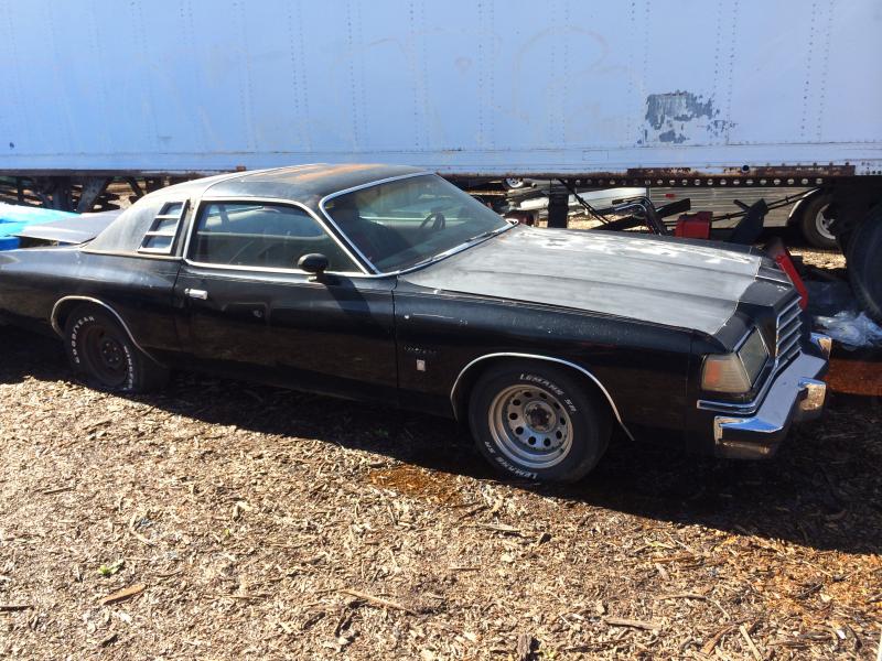

Pickup a 78 400-4 from a storage lot 3 months ago. set 10+ years. Stay in touch. I've corrected sheet metal issues. Planning to install a new tank and sending unit from a 74-76 B body to support a dual exhaust tip from a 74 dodge cmagnum in storage 1.jpgmagnum rear in storage 2.jpgmagnum in storage 2 interior.jpgharger Check other write ups on gas tanks to address replacements or repairs. Good luck

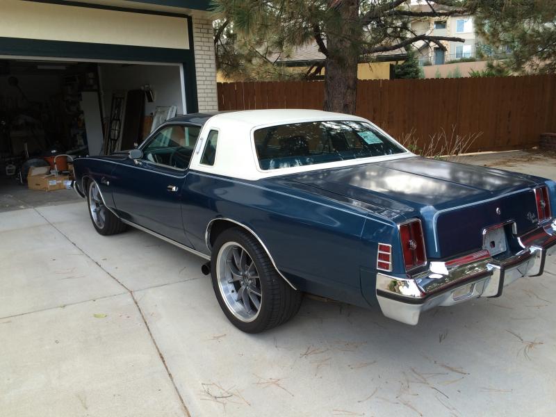

Purchased a 75 Cordoba 400-4 for a parts car to rebuild the Magnum. cordoba driveway.jpgcordoba driveway 2.jpg

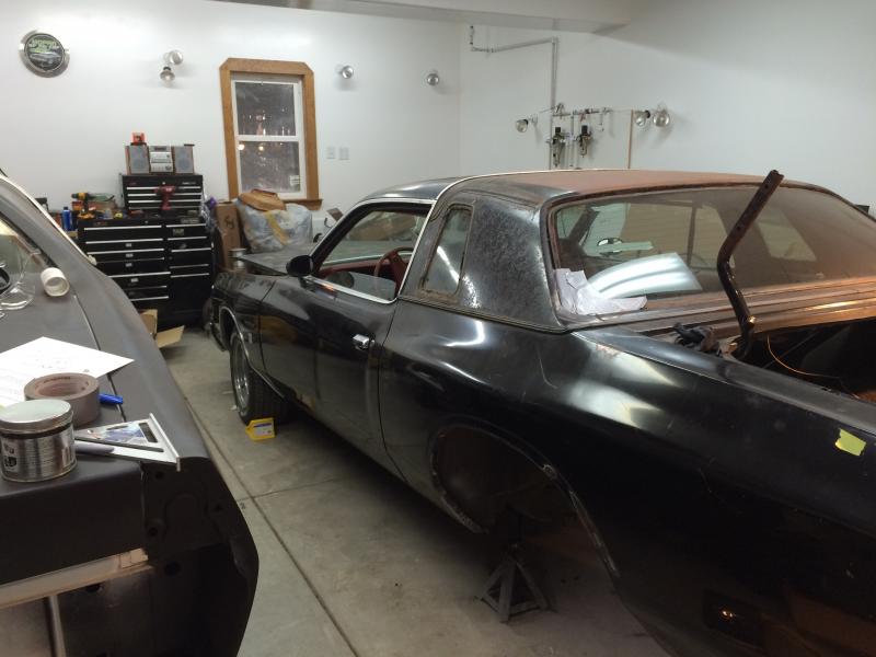

That blue Cordoba isn't the parts car is it?
I have looked at 74-up stuff and the sender diameter is smaller where it seals to the tank. The Cordoba sender looks like the same diameter, but is shaped completely different like it mounts in the top of the tank.

Yes the blue Cordoba is rust free with a 3" x-pipe exhaust system, strong running 400 with bucket seats. I will be parting it out to restore the Magnum.

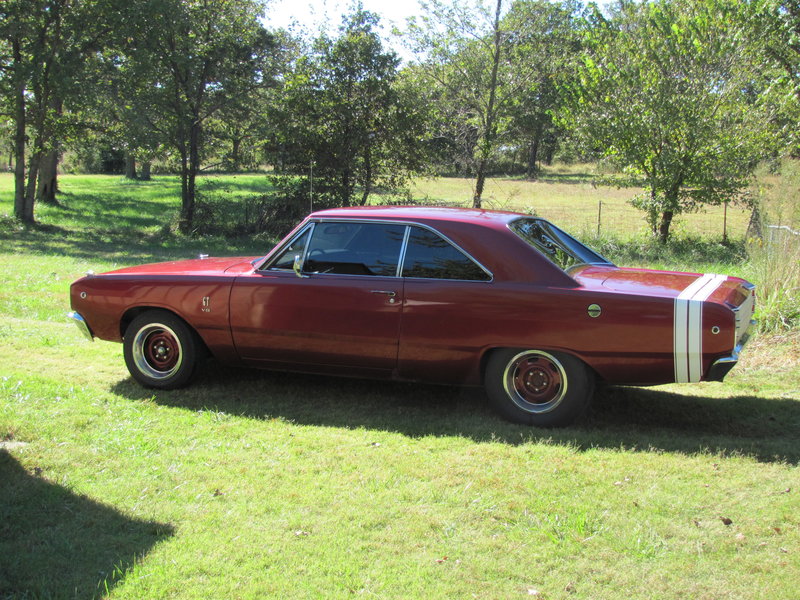

OKDART. do you have a Dodge Dart?

I have a '68 Dart GT
Great color. Noted your rims match, good choice. I also have a 69 GT, body work completed but still needs assembly. Maybe someday I can response with a similar photo. Good luck with the Magnum. send more photos as you make progress. I need the motivation to keep up with your pace of restoration. I have too many projects. The 74 to left of the garage photo need to move forward when I can move the magnum back of the shop.
