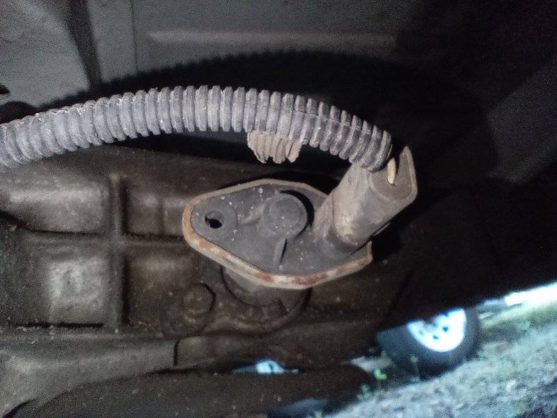

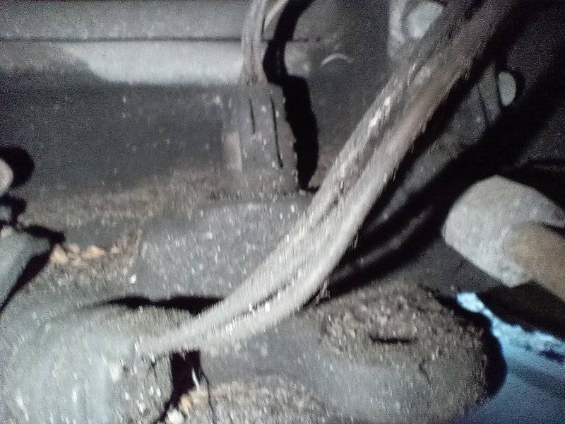

Did some horse trading and I now own a 1990 dodge van 5.2 that doesn't run. The gas tank is out. and the computer is bad. But it came with a spare computer. So if I install the computer and a new fuel pump. And it still doesn't run.... I was thinking to convert it to a carburetor with a different intake manifold and a vacuum advance distributor. Then the only thing that might not work is the transmission. I think it might not work without a computer. Or will it? It has wires at the tailshaft (overdrive maybe?) And two more sets of wires near the shift linkage. Or will I have to find a old school transmission as well? Thanks in advance. Tony.
Im not good with late model stuff, but I do know the 727/904's are hydraulic, as are the RH models....no electronics until the RE models. One of your pics looks like an electronic speed sensor for the odometer/speedometer, and one of the others looks like the neutral safety/backup lights. I think you'll be good...things didnt get too crazy until a couple years later.
Neutral safety switch and electric speedo. ruffcut
