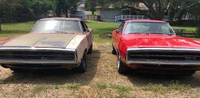

I have another Charger. Some members here may have seen my thread on it...
Lookie what $5000 buys you....
Jigsaw is coded for the three speed wiper option. It has a 3 speed switch in the dash already.

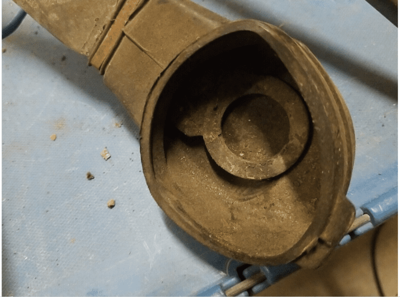

Kern Dog, yes there is a difference in the mechanical linkage between the two.
The 2 speed arm that comes off the motor looks like this.
The attachment hole is large.
The 3 speed attachment has a small hole with a bushing. Plus the hole is offset.

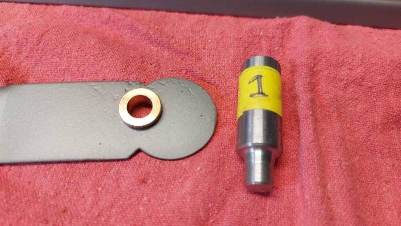

Here it is with bushing installed.
I converted my current 2 speed linkage arm to 3 speed.
There is a guy up here in Montreal that sells a kit to do the conversion.
The kit consists of a round plug to close up the big hole (has to be welded in) and location dimensions and drivers to mount the smaller bushing.

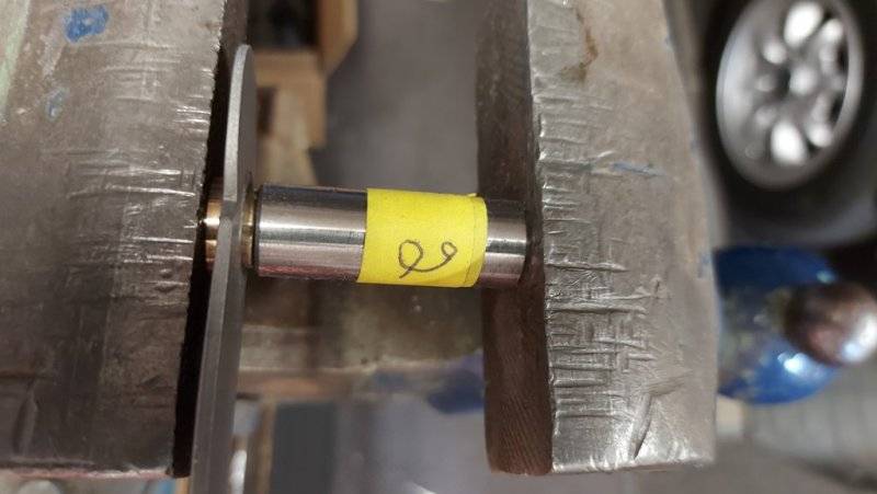

Here's a pic of me flaring the bushing in place.
Then the proper arm that fits to the 3 speed motor will now fit.

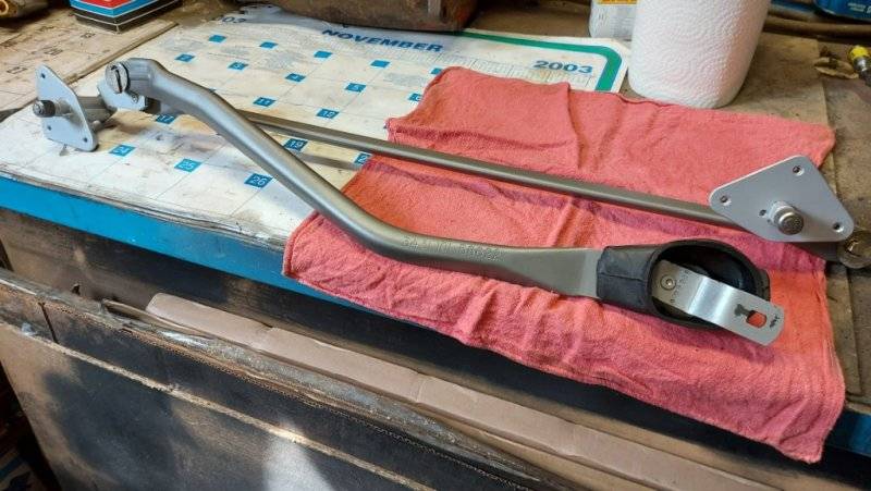

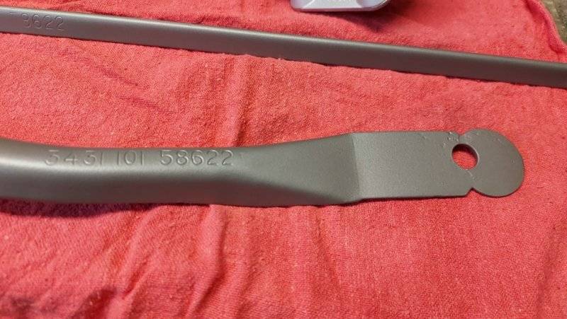

This is the linkage I pulled from Jigsaw, an original 3 speed setup.

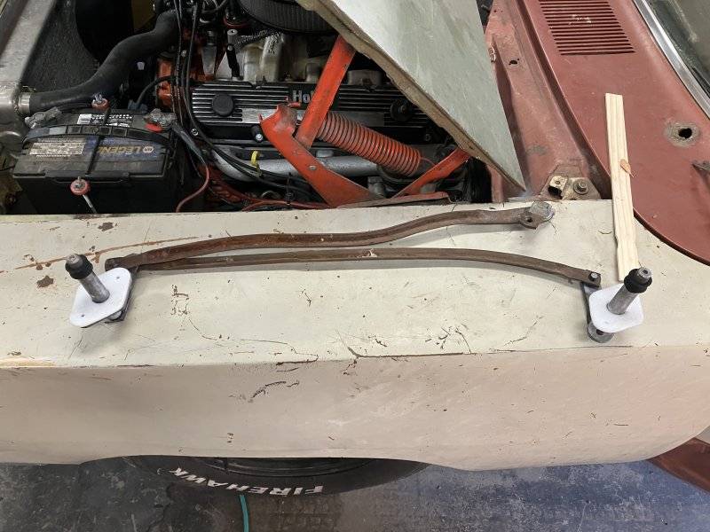

Nope....I just stuffed the parts in with new gaskets. I did run the wire wheel over the pivots and gasket surfaces.
The car will get gone through when I paint it. The linkage isn't hard to reach with no heater box in place.
