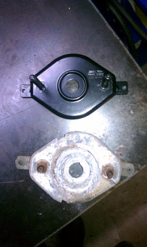

Started hearing a rattle coming from the back of my 2005 Sebring. Turned out it was the upper strut mount. They are made of magnesium and just completely disintegrate into nothing!
Found the replacements at Advance Auto for $27 and come with new rubber. They are made of aluminum and are powdercoated. If you own this type of car, be checking for this.
Yes, they are a problem child. Replace both in the wifes 01 sebring convert and the daughters 04 sebring sedan. Yours looks way better than the ones in the daughters car!
