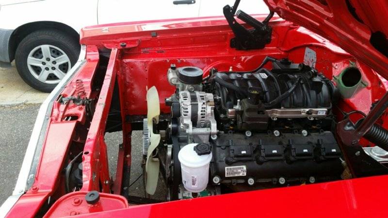

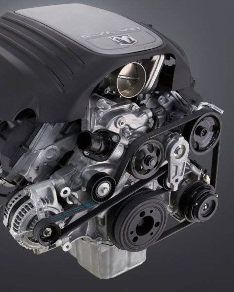

I used a 2016 ram truck motor in my 69 road runner. On my motor the throttle body pointed up making it impossible to put any kind of air intake on. So I had to convert it to a forward facing throttle body intake. That included replacing intake manifold, water pump, timing cover, crank dampener, alternator, ac compressor. It just snowballed into a pile of crap I had to do.

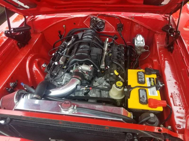

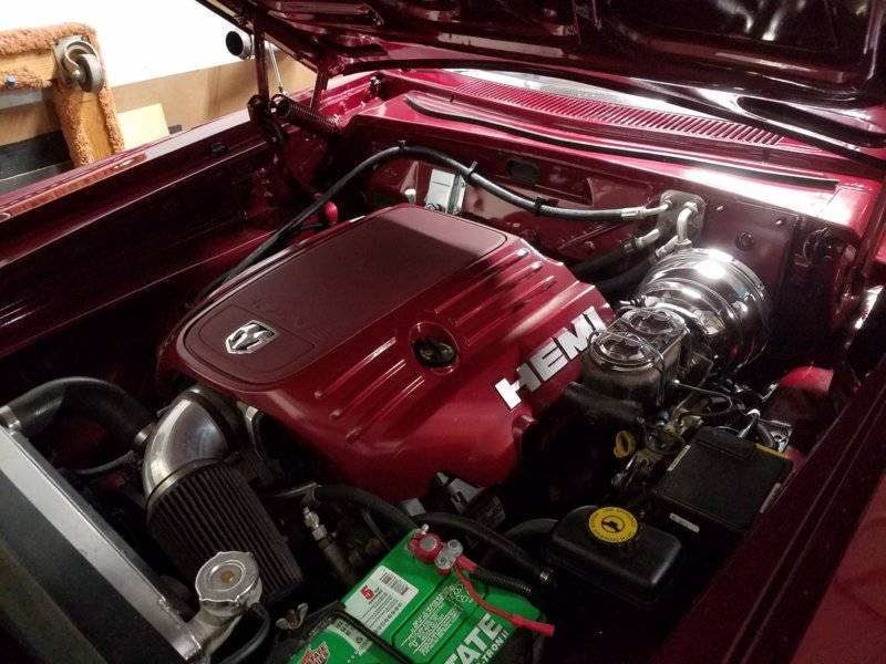

Love what's going on here! this is a 2006 out of a Chrysler 300 with a 2005 truck trans. Both new when installed in 2006
