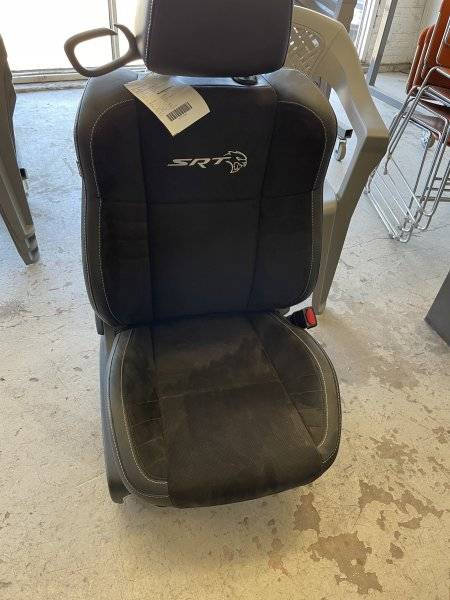

Might be a long shot but need a wiring diagram and connector pin out for some 2019 hellcat seats I picked up for my charger. They have power heat cooling etc etc thanks

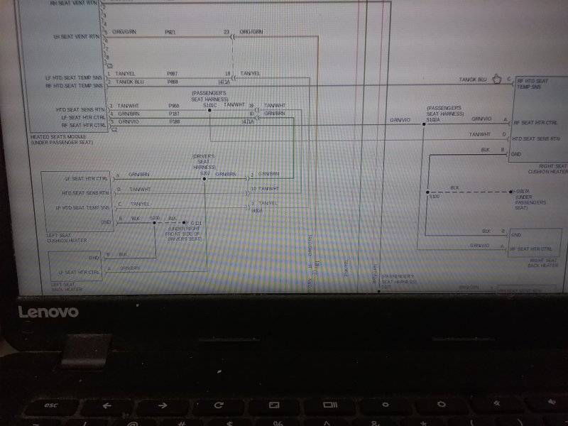

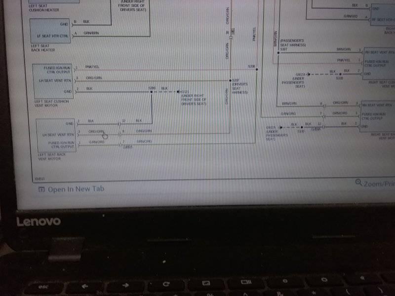

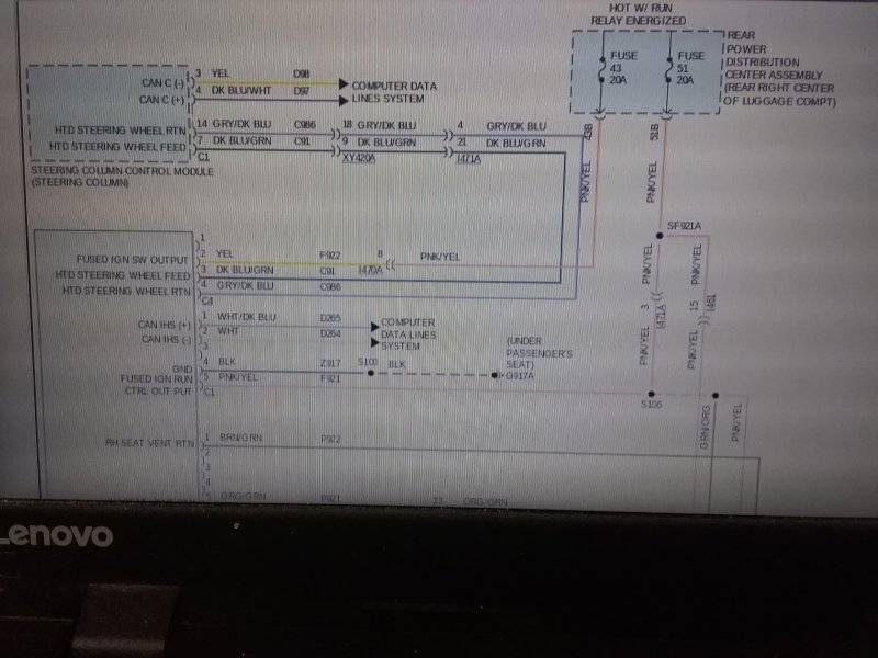

This might help, the pix are rough but its a start
I'll see if I can get a file and send it tomorrow
You can piece them together to get the full schematic

Looking at the schematic hopefully I can make it work standalone. I don’t really need the heat to work but the cooling part would be pretty nice
