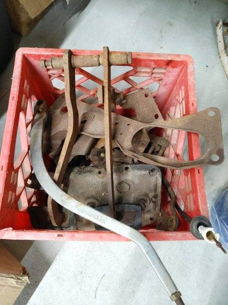

Hello all, I was looking to buy this a833 23 spline for my 70 GTX from a local guy and wanted to see if you think it’s a good deal. It’s a 23 spline, comes with the bell housing, crossmember, pedals, and various other brackets etc. He wants $1500 for it all, looks like the trans probably will need a rebuild judging by the pics. Let me know what you guys think. Thanks!

Complete pedal assemblies are going for 275-300, that bell housing (if not cracked and threads are good) 450 or so, the rear crossmember 80-90. These are the prices you have to pay if you need them, and not a great deal. That shifter stick doesn't have much value, to me at least. That leaves a good 550 left for the trans. I say he is asking to much especially seeing the weld. What else was affected internally when the damage was done? I wouldn't give more than 250 for that trans.

It does come with an extra side cover, as seen in the milk crate.
