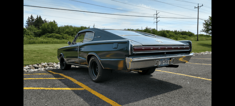

Thinking of this size for my 66 charger rear. Says I need 8" rims and I was wondering about this being a good fir? Anybody running these and if I buy new 8" rims what should I look to have for backspacing. I currently have 7" rimes and I want to go a little wider? Thanks

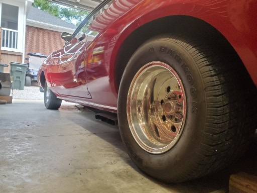

I am running these on a 71 Charger with 10" rims.
With an 8" you could safely go with 3-1/2" BS. With a 10" wheel you'd need 5-1/2" and possibly a 1/4" spacer

I believe I've seen this car and it has 275/60R15s..
I have 295/50/15's on 15"x8" on four different sets of rear wheels and tires. However, none are on a 66 Charger but they will also work on a 66. I don't like the jack up look so I try to keep them low.
