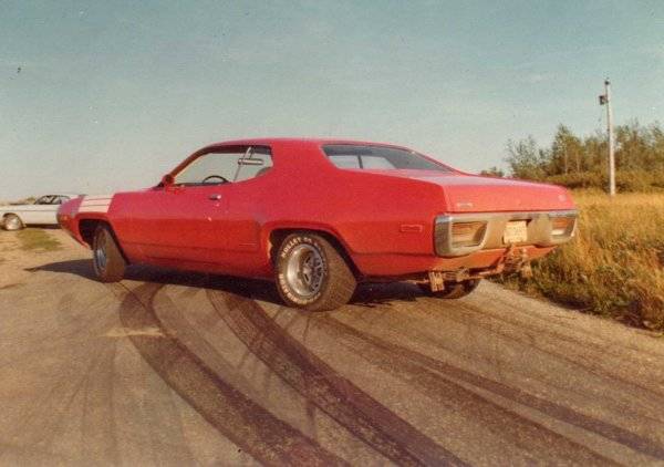

Had Holley Pro Dominator G50 14 , back in 1975

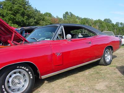

I have 2 sets of 295/50/15's on two different sets of 15" X 8" wheels. One set a widened factory Rallye's & one set of Cragars. Both have a 4-1/2" back space. No rubbing issues anywhere, even with 4 or 5 people in the cars when I haul the kids & their friends around.
Believe it or not but our older Chargers have a bigger wheel opening than a 72.
