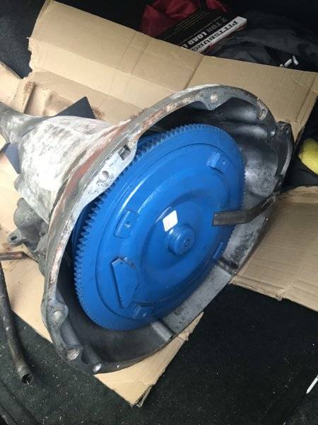

must be a cast crank motor, I see a weight on the converter
I assume your running a big block? The converter weight appears to be a 360 weighted converter and I believe most big blocks had two smaller square weights welded on. Could be "Whole lotta shakin going on".
400 and 440 cast crank engines have a similar weight about 12 ounces I believe. 360s weight is around 19 ounces. That weight isn’t thick enough to be a 360 weight. I think it was 76 or 77 that Chrysler went to the single weight. Kim
Yes. 1978 440 RV motor.
400 and 440 cast crank engines hace a similar weight about 12 ounces I believe. 360s weight is around 19 ounces. I think it was 76 or 77 that Chrysler went to the single weight. Kim
The engine, trans, and TC are from different places. Not original to the car.

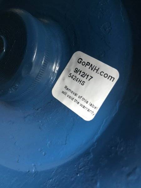

5424HS comes back as 400-440 cast crank, it's the right convertor..
