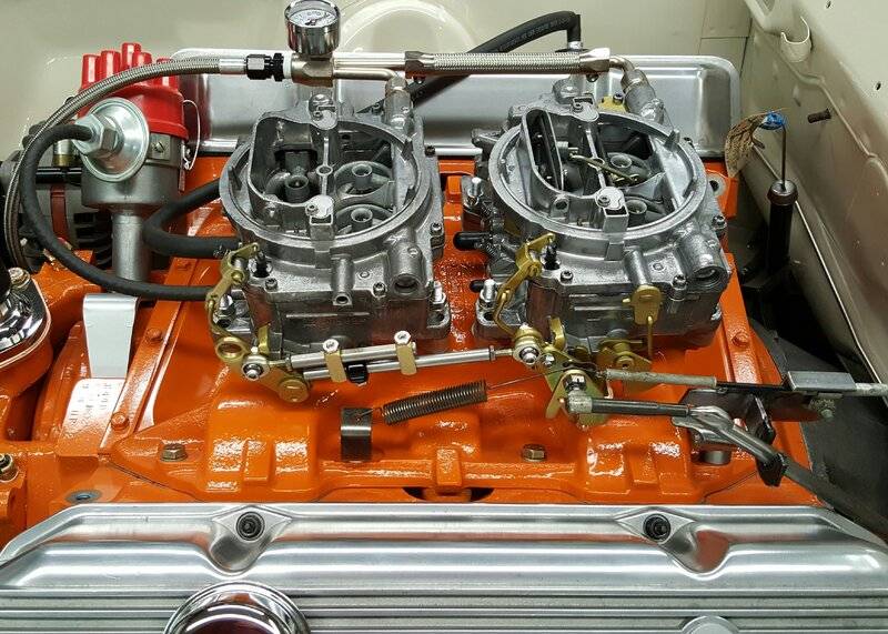

The solid/one piece kickdown rod I modified. That's the crazy bump in it after the threaded section. It was the original one for the 361 with a four bll. I would like to find a factory 413 (RB) rod or better yet a factory 413 2x4 rod. That's the only Raised Block back then that was available.
The throttle cable is the original one for the 361.
Throttle bracket I modified also.
