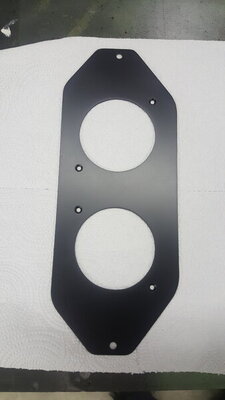

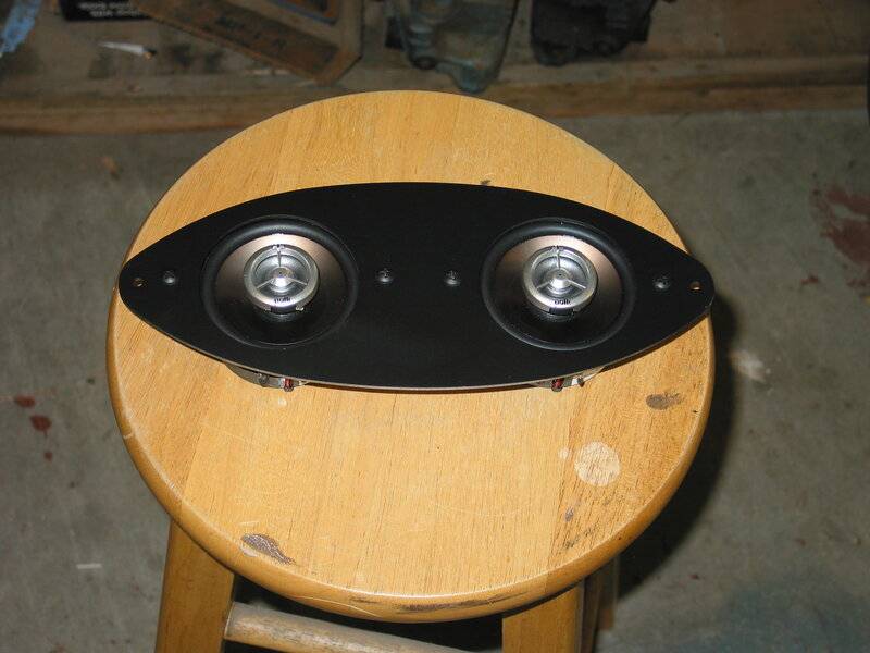

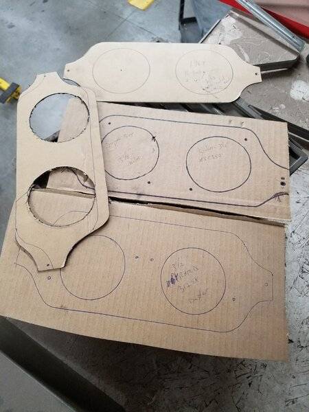

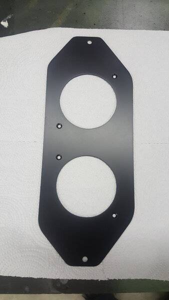

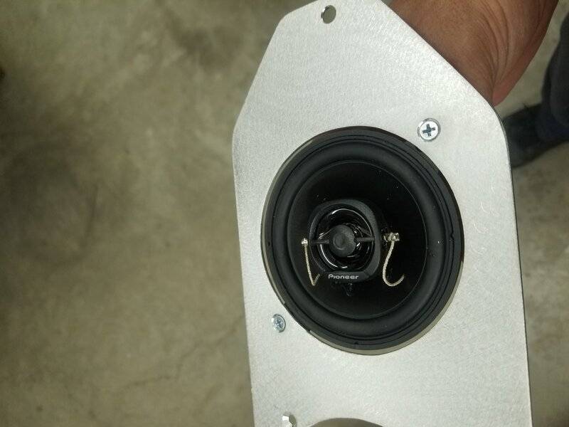

I bought one years ago. After paying $60 or so and finding out it wouldn't clear the heater control, I made a couple of templates and make my own now. Been using 1/4" plexiglass and painting it black.
