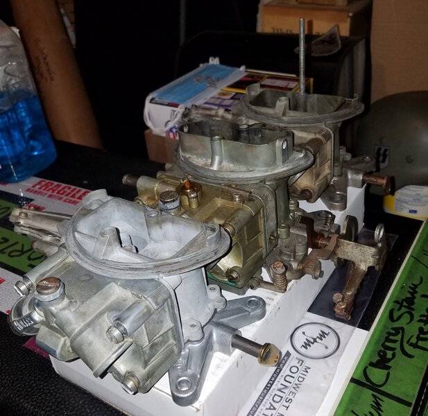

Well, had enough of the 51 year old units. Ordered 3 from Holley. The 4144 is already here. The outboards expected around the 11th (August)..
Holley says, "These are Wet Tested, and ready to bolt on" I'm wondering.... How true this is. I explained it's a 390 HP Six Pack A12. (Bee). Wonder if ANYONE else here has done this exact same operation?
And how did it go? Guess I should keep the originals. Althought the front outboard is INCORRECT, it has an accel pump housing that's been filled in. Sight plug screw isnt lower like OEM should be.
I do know this was NOT CHEAP.
Thanks-

Here are numbers from Front to Rear:
3139
List-4382
2239
List-4144
3149
List4383
♤Just a little nervous about all of it. Considering I just rewiered the entire car last month...lol
The front Outboard was taken off, and already cleaned. It had a stripped Idle Air screw, WILL need baseplate. Or screw reworked for certain.

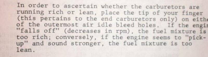

I would set the outboard mixture screws 1/2 turn out from seated.
That may be fine as a starting point, and it may just be the right setting,
BUT!!!
THIS is absolutely THE best way to set the outboard carbs idle mixture screws, and this information couldn't be any more valuable if it would have been handed down from heaven on a sheet of gold, nestled on a silken pillow, surrounded with laurel boughs, with a host of Heaven's angels singing the "Hallelujah Chorus"...
Wide shot for context:
The important part:
And how BIG of an improvement it made in my progress to get my 6bbl working properly:
