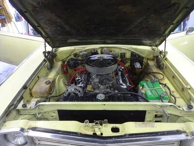

So guess what?!? I took my sons (3 and 6 yo) over to my parents house (10 miles away) and planned on taking my dad out for a spin. Figured 3 generations, old car, nice cruise....woo hoo. Problem is, I pulled up to my parents house with coolant/water pouring out of the front of the engine. On first inspection, I thought it might be coming from the lower portion of the water pump gasket (which would make it my fault). But with dad and a flashlight, we could clearly see the coolant pouring out from behind the fan pulley (ie water pump). I can't tell if it's coming from the weep hole or the seal around the water pump shaft bushing, but that's it. So.....what am I doing wrong?? I'm not a mechanic, but I'm also not an idiot. The belts have never been overtightened (I learned that lesson 20 yrs ago). I put a thin layer of grey RTV on the pump mating surface, then the gasket (no rtv on the block) and torque everything down in a cross-wise pattern to 30-35 ft lbs. I use RTV on the long bolts and even clean the threads of the bolts each time. Also....I've not had it leak from the gasket yet. I've not replaced the thermostat, but my aftermarket engine temp gauge reads 130 (min reading) on start up, climbs to 180 and it lives there whenever I drive it. The only time I've had the engine temp reach 220 is after the impeller first broke (I confirmed that no pieces were missing from the impeller) and the engine continued to warm up after it first broke down (see above link).
As a side note....to try and do some engine 101, I bought a compression testing kit (2 weeks ago when everything was running fine) and tested each cylinder by pulling the spark plugs individually. I did 3, 4 sec ignition turns on each cylinder and they all ranged between 165 and 180 psi. I felt like I learned a little and had a base line in case the engine started acting funny later. My point??....my head gaskets etc should be in good order.
So...am I doing something wrong (besides getting NAPA water pumps)?? Or is this one of those fluke 'bad batch' of water pumps trilogy nightmares?? I don't see any coolant leaks anywhere else on the engine and the heater core plumbing isn't even hooked up. I'm not a mechanic, but this seems weird. I have no problem buying another water pump (different brand - maybe direct mopar/chrysler) but I'm worried I'm missing something.
I've talked to a couple mechanics (including the man that built the engine in CO in 2016) and they all said to stay away from parts stores water pumps and buy something Chrysler/Mopar made. I like fixing things on this car, but not the same dang thing over and over!!! HELP!!

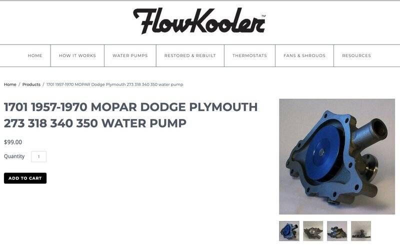

twecomm suggested FlowKooler. I found model 1701 that looks right. Also heard GMB from a few people on here. Other advice/opinions?
