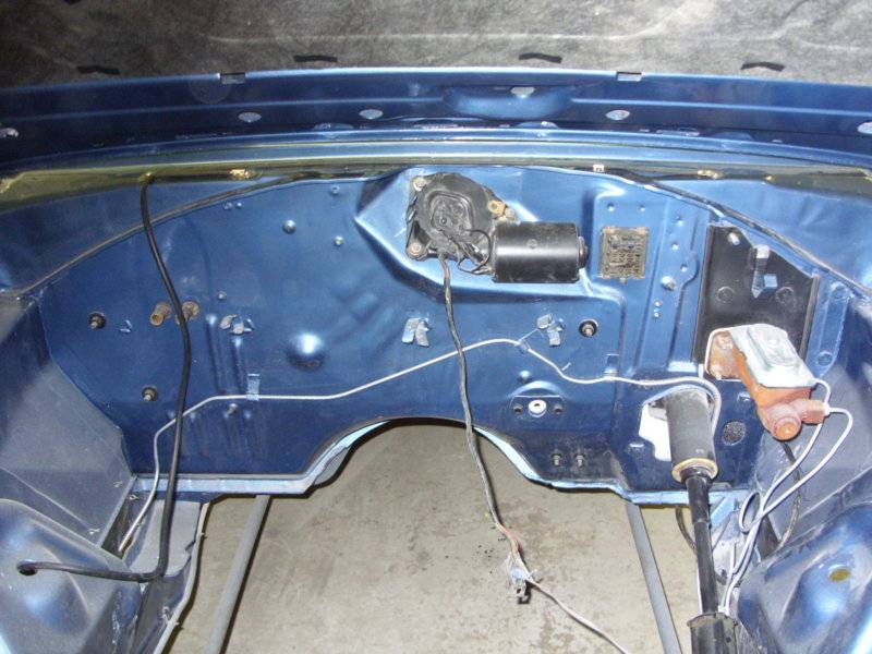

Om my 67 gtx that I got from my dad it has 3 speed wipers. They never worked right ever since we got the car done. Ive bought & tried several wiper switches & they still don't work right. They have only one speed & the wipers stop at where you turn off the switch. So made a ground wire & grounded the switch. Now the wipers work like they should for the most part. Now the wipers will not turn off & stop at the lower position like they should. Is it the motor ? Does anyone have pictures of the difference between the 2 & 3 speed wiper motors for 67 ? Ive seen 2 different types of canaster type motors. One is gold in color & the other is black. I know what a 2 speed motor looks like from 1968 & up. OK HERE IS WHAT I FOUND- THE MOTOR ON THE CAR MIGHT BE THE WRONG YEAR. Inwich it will not work right. Does this sound right ?

this is what was on the car when my dad bought it back. "he bought it new" It looks like the newer style I just bought a rebuilt one on ebay. The motor "canister" looking thing is half silver & half black. The guy says its a variable speed for a 67 belvedere
I don't know enough about '67's. Maybe late production cars got the new style motor. Either way, I'd start with a bench test
