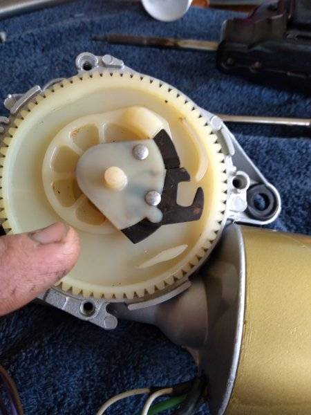

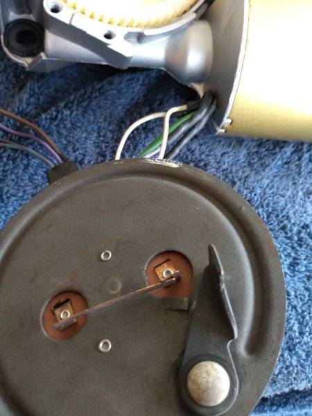

Hi guys need some help I'm in the process of restoring my wiper motor and I screwed up and didn't pay attention to how the gear and latch for the wiper motor came apart the motor came out of my 1969 roadrunner any help would be great pics or service info would be great thanks guys
These are the two parts I'm talking about sorry
It shouldn't matter - they will orient themselves in the "park" position. Do a bench test after assembly.
