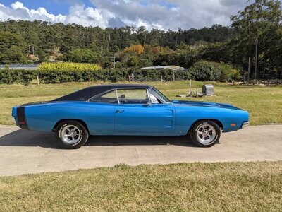

Hello all,
I currently have 15x8" rims at the back but looking at putting 15x10" which is the biggest size in that rim (American racing Torq Trust). I would really love to stick to the same rim, I just love the shape.
I know 295s are the better fit but I love me a big fat tire at the back. Has anyone fit 305s on this 10" rim? Would it bulge too much.
thanks for any help!
305/ ?x15 ?? Who makes a 305 for a 15"wheel? What aspect ratio? Did you mean a 315? A 315 really needs a 12" wheel.
Also, if you are looking at the one piece 15x10 torque thrust, it doesnt really have enough backspace to tuck the tires in nicely. I think they will stick outside the fender. You would probably need to use a two piece tt.
A 15x10 tt is really 11" wide, probably needs 5-5 1/2" bs, one piece tt has something like 3 1/2-3 3/4 bs.
Thanks mate! That is very informative, eye opening. yes the 10" TT has 3.77 backspacing. So it seems like I'll have to look for different rims.
