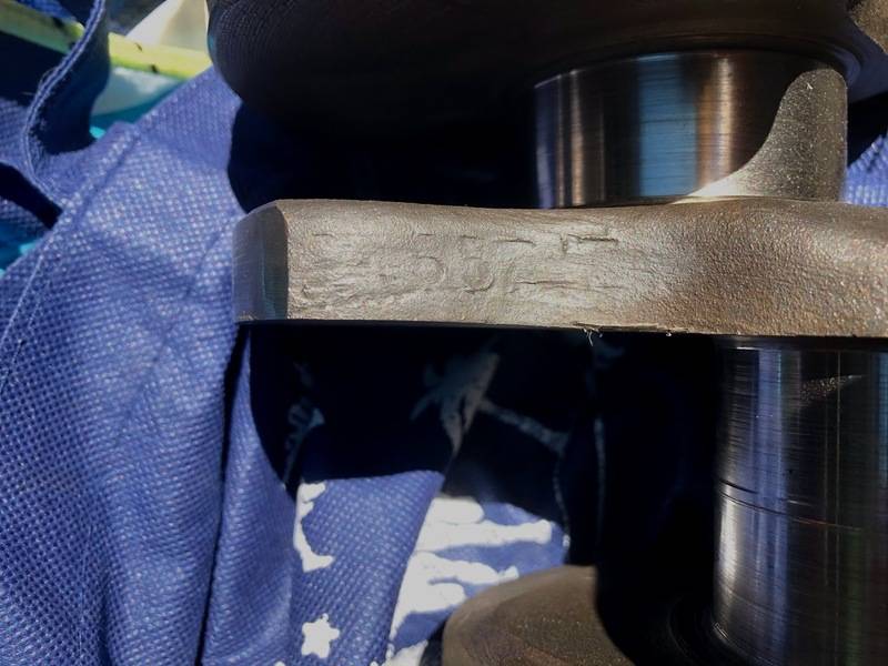

Can anyone help me ID the stamp # on this crankshaft?
1968 318 Satellite - it's totally shot and I need to replace, but am having a hard time verifying what cranks will fit!

Chrysler small block stock crankshafts all have a 3.31 stroke. Main and rod journals are the same size also. Differences will be the amount of inertia/stiffness, forged steel or nodular cast iron between 273, 318, 340.
Show a pic of the rod pin end of the crank. I need to see if the parting line is wide or narrow. Wide is steel, and narrow is cast. A steel crank will be the same as a 340 crank (same main and rod size), but the cast will depend on a few things. The shape of the crank throw you show looks like it will be steel. Casting number won't matter is it is steel, 318/340 steel internally balanced crank will be what your looking for.

I had it ground last summer, but they took too much off and it wasn't true. So ended up making some nasty noises. Basically they botched the whole job and now the crank is destroyed, pitted, lopsided. So I gotta get a new one.
It's definitely steel. Maybe it isn't even the original crank (engine was rebuilt once already when I was less knowledgable and more hands off).

Call a local machine shop, and ask for a crank kit for a '68 318/340 Steel, internal balance. If they can maybe cross an EPWi number, PN#93570

Totally shot? What's wrong with it? They can be turned and polished you know. Not all but pretty much any 318 crank can replace that. Can't read the number

It was turned and polished last summer. But the turning wasn't true and they took off too much material. So the journals have ended up lopsided and even more deeply gouged after only a year of use. Furthermore the sides of the journals are worn down. It's just a useless piece of metal at this point.
