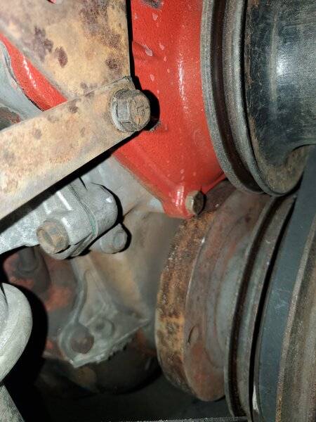

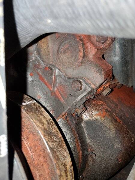

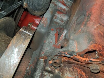

Post some pictures of both sides of your timing cover. My bets you have a water pump outlet covering them up. Mismatch of parts.
I have a similar thing going on on a 318 w. A/C. The bottom radiator hose covers the timing mark on the left side of the motor. I can find it, but only from one very narrow point of view.
A '69 uses a bolted on pointer on the passenger side, and the balance will match. The lower water pump port is on the driver side, so the timing marks are on the passenger side.
The timing plate on my 318 Poly bolts to the pump and is on the passenger side. Problem is some of the A and LA 318 parts are interchangeable, water pump being one of them. Just to make sure, I brought the engine to TDC and checked the balancer for the mark.

i had a quick minute and here are pictures of both sides , as I've said before this is my first Plymouth so I am not sure what belongs and what doesn't ? I did see that you can buy bolt on pointers but they all appear to be for big block , does that matter for this particular application ?

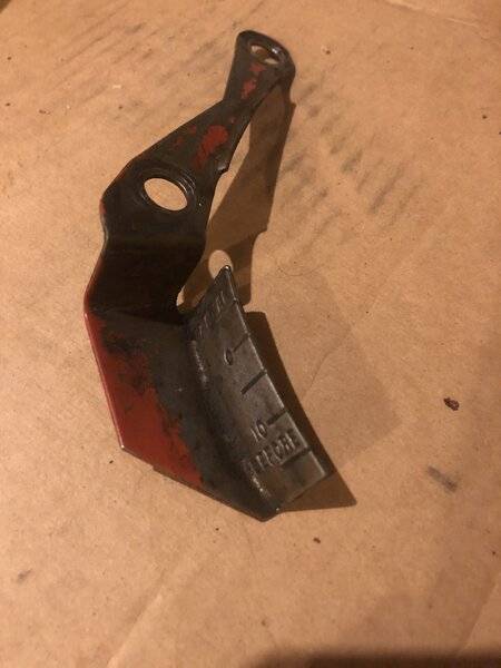

MOPAR 273 318 340 LA Engine Timing Mark 1964 1965 1966 1967 1968 Dart | eBay
You will need to pull #1 spark plug, turn the motor over by hand, and using a finger in the plug hole, turn (or use a helper) by hand until you feel compression pressure. Use a long phillips and rotate the crank until the piston is at tdc. The balancer mark should be on the passenger side. If it is on the driver side, you either are going to need a balancer too, or convert over to a late cover, but the lower hose makes it hard to time.
$10 plus $8.50 to ship it by small flat rate box. It’s for the passenger side with the cast iron water pump, which I see you are running! Let me know if you need it.
