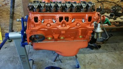

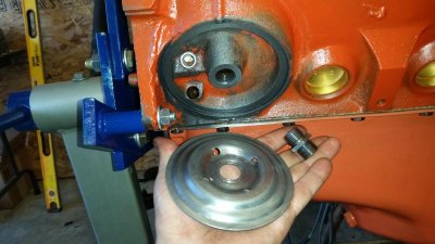

Hey guys i just got my 318 rebuilt, putting it back in my coronet. but for some reason i can't get the oil filter base to seal up, i have inspected all the flanges, nice and smooth and clean, i used a factory gasket with sealant, that didn't work so i tried no sealant, and then i tried gasket with the right stuff gasket maker, and then i tried just right stuff gasket maker, WTF...im loosing my mind here this should be a simple task.
It has a high volume oil pump (not high pressure) but that shouldn't be a problem, i have the engine on the stand and I'm glad i checked before i put it in, i used a oil pump shaft primer and a low speed cordless drill to prime to oil system and the oil filter base was leaking like crazy.
here is another good question, why doesn't dampener line up with the zero on the timing gauge when i am at TDC on piston one? the damper has timing marks stamped into it, but they wont work, its like i need to buy a timing sticker and stick that on there.

Never have messed with a 318, but just looking at the parts...
The filter plate just goes on one way, from the looks of it, so I'll ask this. Without the plate's gasket, when you position it onto the location, from the outer flange to the inner flange, do both contact the pump surface?
Thinking the inner flange, where the filter threads hold it in place, should be off the pump surface a little. It would take that to 'tighten' the outer flange against the gasket. Wondering if the plate could be too loose. You might need to 'shift' the inner flange a little to tighten it up.

ok guys thanks for your help. so on my 15th attempt i got it to seal up. i ended up making a cork rubber 1/8" gasket for the big one the thickest material i had to get more clamping force, not using a small gasket to increase clamping force and I'm not worried about the slightest leak by there, and i drilled 4 more holes in the plate, the other thing i did was used a bronze thrust washer between the plate and fitting to help spread out the clamping force to the outside edges. and it worked great....finally! thanks for all your input. I'm not sure what to do with the dampener, i think I'm just going to run it and time it by ear/feel.

On the oil filter plate issue: Make sure you are only using the large outer gasket with the plate. There should not be a gasket where the threaded part goes.
I usually coat the gasket with Permatex Indian Head gasket shellac. Now the trick is pre-fitting the filter plate to the block. With no gasket, the center of the plate should not touch the block. You want to place the filter plate on a non-scratching surface like plywood, and lightly pound the center down a bit from the back side of the plate.
When you put the filter base on the block with the outer gasket, there should be a slight distance between the center of the plate and the block, then when you tighten down the threaded part, it will pull the filter plate down tight on the gasket. Also, the oil filter will also push the plate into the Block when you tighten the filter.
