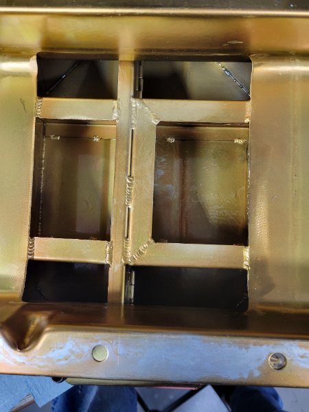

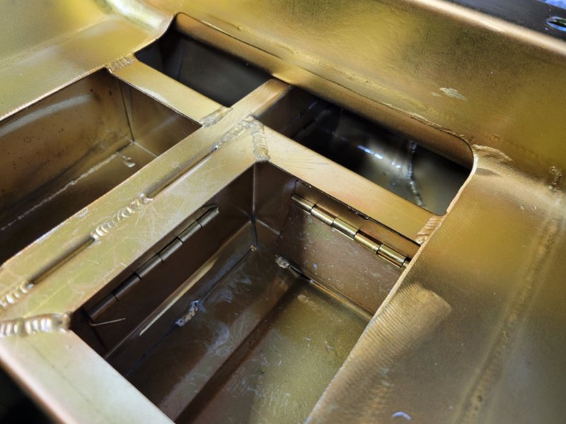

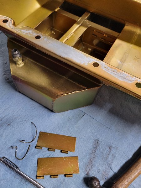

I have a Milodon road race pan on my '69 Hemi, for ground clearance, not road racing! Just looked, Milodon doesn't offer one for the small block. Maybe give them a call and see if they could make one. The pan has 6 chambers with hinged doors to block and open when cornering or stop and acceleration. I removed my side to side doors.
I personally can see no advantage in removing side doors, even in acceleration, actually I can see a few negatives, first being is making the assumption there are no windage forces at play side to side when accelerating.
