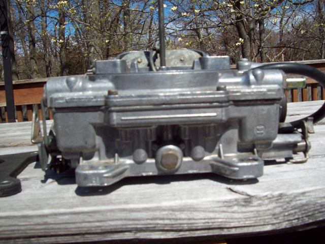

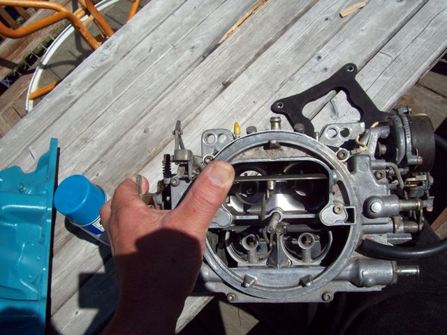

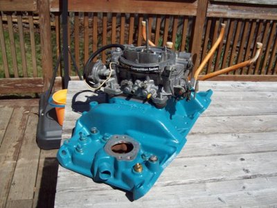

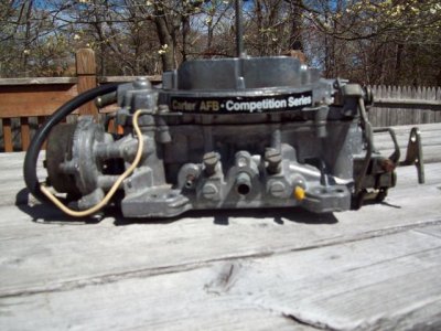

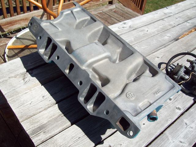

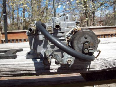

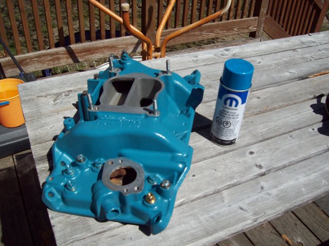

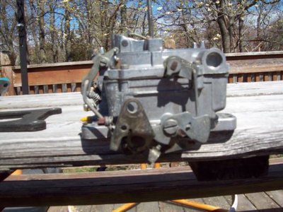

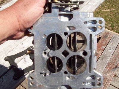

And, again, IF, if your interested, I have a older Carter 9636 Comp Series AFB that I used for a while. It is in generally good clean shape and in good working order when I drained it to shelf it. I'll include a Edelbrock "Thick" gasket to protect from heat and the studs that go with it.
I'd sell for $250 shipped, I'll post some pictures in a minute.
A stock thermoquad intake is almost as good as that overpriced POS. Please don't buy that. You can do much better. Hell, buy my motor. I caint go 1500, but I can come close. Shippin is another issue.
Here's the Carter 9636 with the thick Edelbrock heat gasket & the Edelbrock Performer freshly painted in Chrysler's MoPar blue engine paint.
Looks great, Rob.
