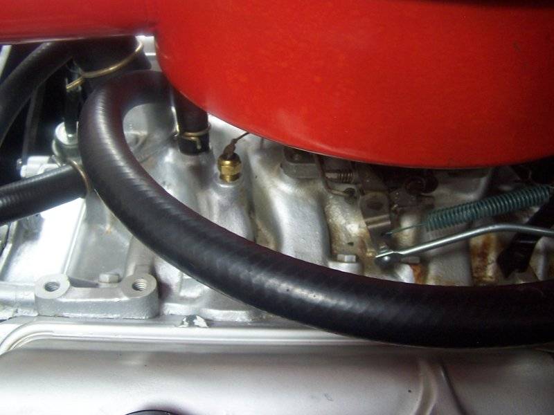

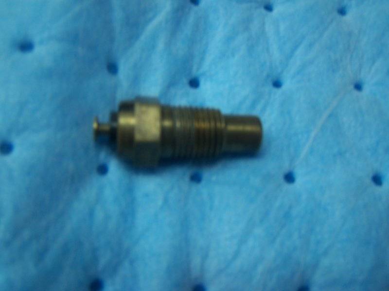

Here are a couple pics of my 60 318 Poly. The sender hole is on the drivers side between the carb and radiator inlet. 1/4" Pipe thread. Also a pic of the correct sender for a gauge.
I have the sender for the idiot light, but no aftermarket temp gauge has a sender small enough.
Thats what I was thinking. Is there any way of having a temp gage?
The sender in my picture is for a gauge. What car and what year Poly are you working on?

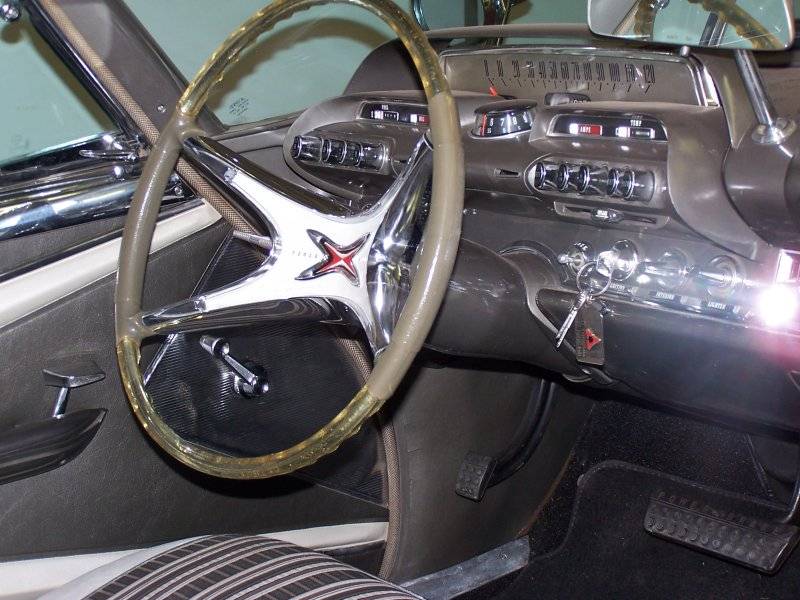

Well...........I guess my gauge don't have numbers either. Just the L and H with a bar in between. Mine runs just a little left of center on the bar. I figure if it gets over half way to the H, I better start watching it closer. I guess you could mount an aftermarket gauge with numbers under the dash and use an adapter in the provided 1/4" pipe threaded hole. To me the temp gauge is better than the idiot lights I have for the oil and amps.
Very nice dash! Beautiful condition! I didnt know if they made a "special" adapter for a gage?

That is the exact size that is in the picture I put on post #3. 1/4" pipe thread is the size that is drilled in your 318 Poly. Same as mine. 1/4" pipe thread is the threads on the factory sensor. 1/4" pipe threads are what are on the probe that is included in the aftermarket gauges I referenced from Ebay.
Go to the hardware store and buy a 1/4" pipe nipple. It will screw right into the hole in your intake the same way that probe included with the aftermarket gauge.
That 1/2" fine threaded fitting you mentioned in your first post is actually a 1/4" pipe thread.
