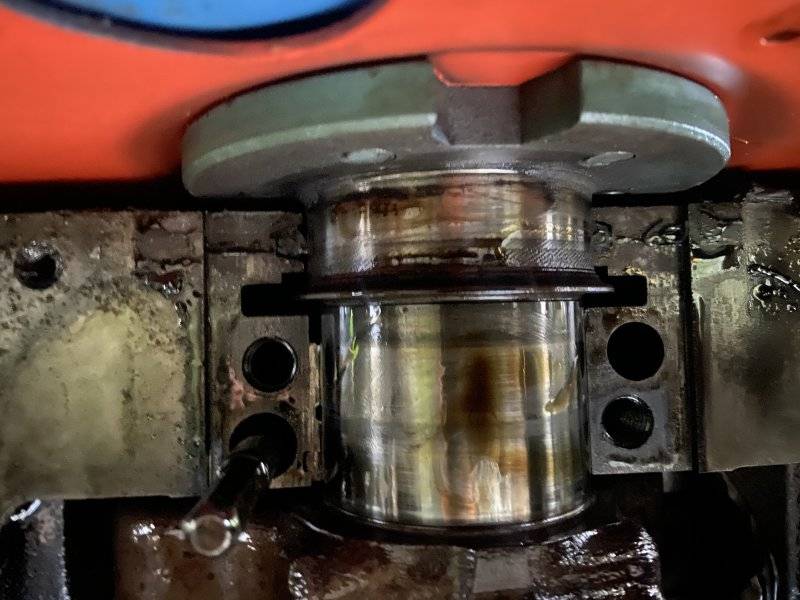

Well, it may not be a rear main seal leak after all. From what I can tell the oil seems to be leaking from the rear corners of the oil pan. Although it could also be just the crank slinging it to those sides. The inside of the bell housing does have a film of oil.

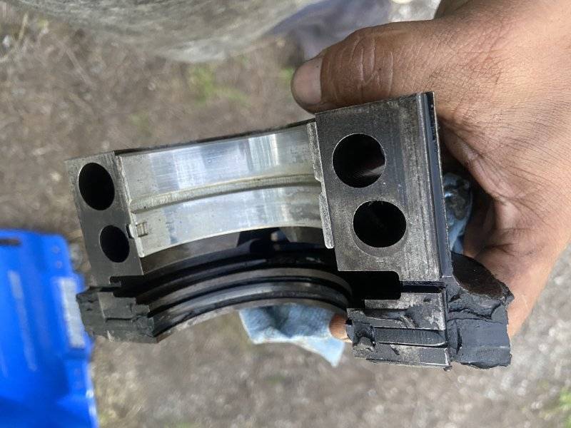

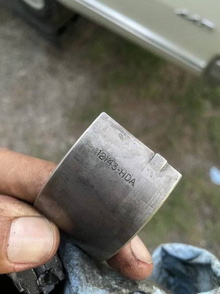

What do y’all think about the wear on the main cap bearing?
