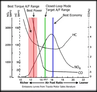

The air/fuel mixture to start and idle from cold needs to be high 10:1 or so with any carb. After the car warms up, anything in the range of 12-17 will keep the car running with varying levels of exhaust output.
