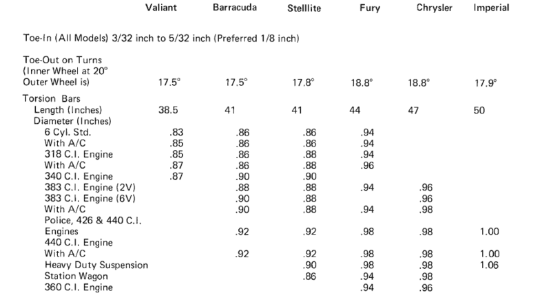

I don't have a Dodge shop manual, but the 1971 Plymouth FSM shows this chart which has the different diameters for various engines. Note the factory mis-spelled Satellite name. :)
Thank you for sharing this. Very good information from a solid source! The misspelling is funny! Lol
