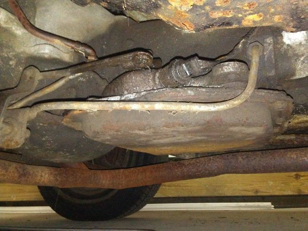

Is there any telltale sign of a 904?
Better yet, can anyone here tell by this pic?

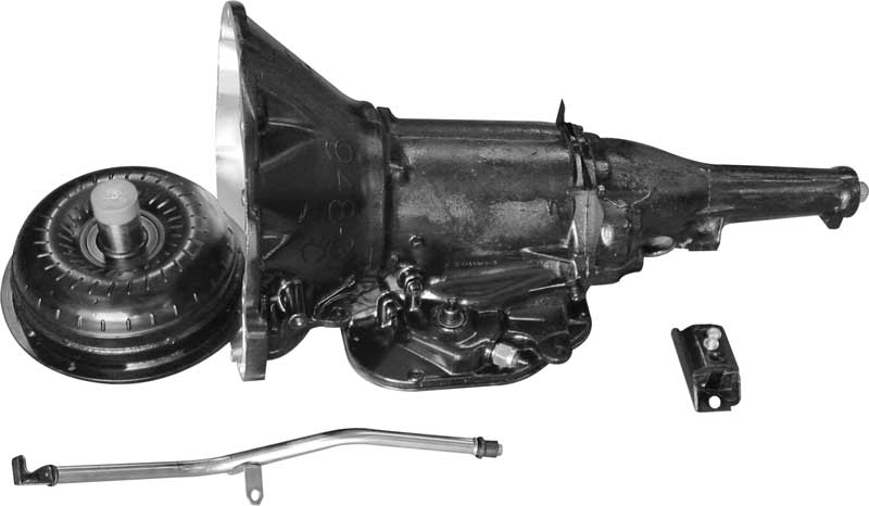

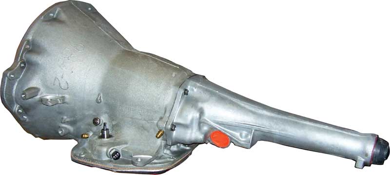

One thing I've learned long ago is it doesn't matter what your car came with, what matters is what it's got now, so always take the time to see what's actually there. :) I think the biggest visual tell between a 727 and a 904 is the body. A 727 has a flowing contour from front to back, and a 904 looks like it has a can in the middle of it.
727...
904...
I can't really tell from your picture, but that looks like a 727.

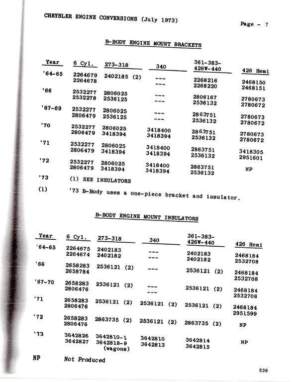

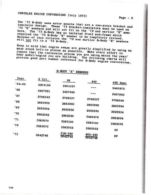

Guys,
Here is the difference between the 1973-1978 SB K-frame pn#3642744 and the BB K-frame pn#3642748 This info came from the Chrysler Engines Conversions section in the Direct Connection Racing Manual ("The Bible") I have included a picture of both that I found. I hope this info helps.
As mentioned...
Conversion mounts are needed for 73 and lates but all V8s used same K member up to 72. Just get the right stock piece engine mount.

not in this case, the car is a 71 and the k frame is the same for a v8 except Hemi,he just needs brackets
Your absolutely correct. 71-72 SB & BB use the same K-Frames. I guess I did not read the first post.
Sorry for the confusion on my part.
