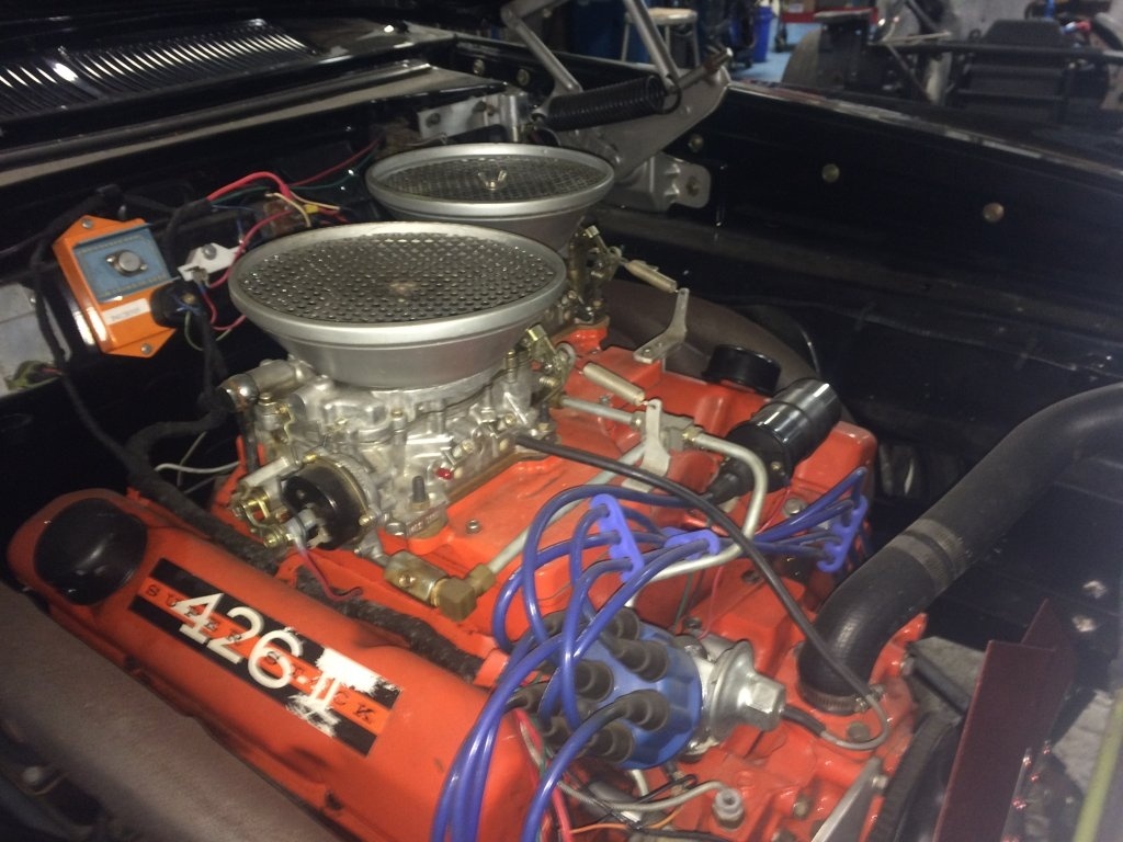

Original..... no. Maybe the intake and exhaust manifolds are oem, but the carbs, distributor, carb linkage, fuel lines are not. Do the heads have freeze plugs on the ends? If they do they are not oem max wedge. For quick ref the front of the block on drivers side will have aaqa stamping on it.

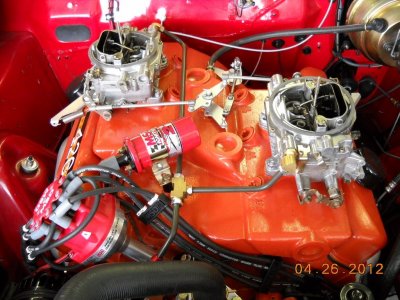

Sorry, that's not a max wedge intake. Note the position of the carburetors...
Coloradodave is correct, that intake doesnt look to be oem, might be an edelbrock str type, which is a cross ram style manifold.

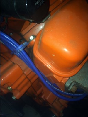

The heads are the 4 bolt, probably 286 casting stage I / II head. You'd have to remove the drivers side rocker arm cover to confirm.

You are prolly right. After looking at some of the images online, that str intake lines up. We pulling the engine tomorrow. Pretty sure it has a spun bearing. Prolly a clone.
Help me out here aren't the 4 bolt and 6 bolt valve covers interchangeable.
A 6 bolt will fit on a 4 bolt head and vice-versa.
If so the number of holes in the cover does not tell you the casting numbers.
