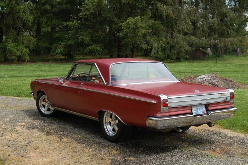

335/30-20 or 345/35-19?
andyf
9:22 AM
Jul 21, 2012
952
1,558
Oregon
I'm trying to figure out which is the best size of rear tire to go with on my '65 Coronet. I currently have a 315/45-17 tire out back which is a super nice tire but I can't find them in that size anymore. Looks like I need to go to a 19 or 20 inch wheel in order to find a big tire with a 28 inch diameter. Anyone know of other alternatives?

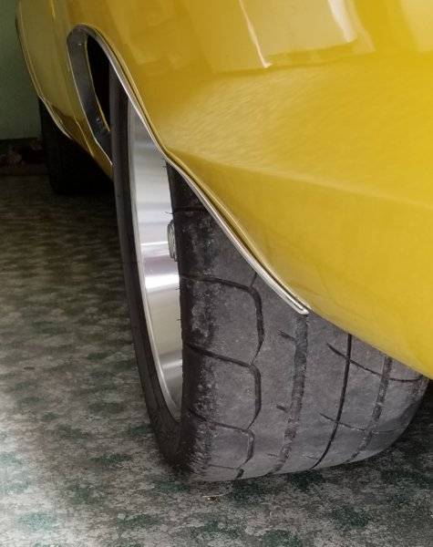

I have no intention of ever going back to 15 inch rims and tiny brakes. I like the look of the 17 inch rims that I've had on the car for the past 20 years but it appears to be impossible to find replacements for my existing tires so I think I need to upgrade.
I run 315/35/17 on my totally stock suspension and 5" backspaced 9" wide aluminum Rallye wheels. The factory should have sold the cars this way.
Toyo Proxes TQ drag radials.
Go 345/30-19 tires if you can fit them. Several choices of brands to choose from. Z06 vettes and Vipers use them.

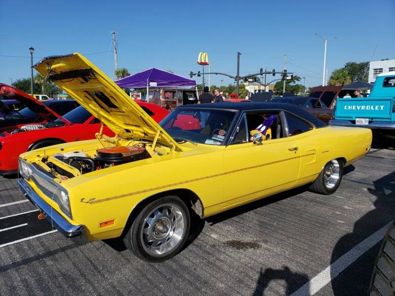

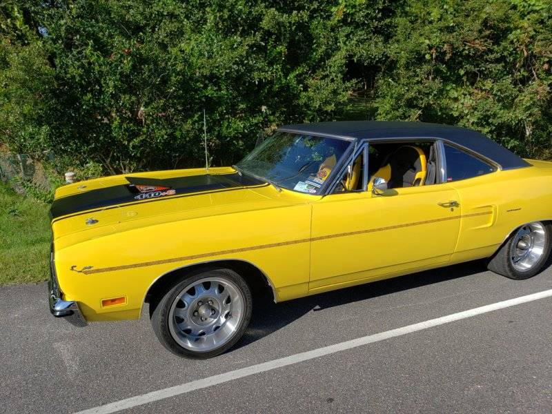

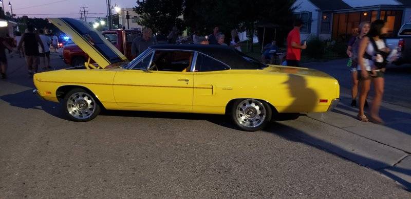

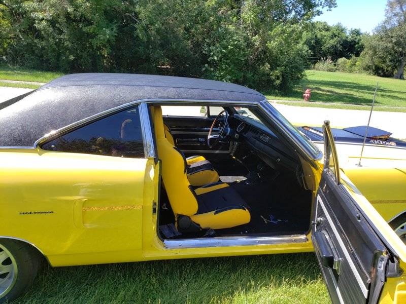

Do you have any threads on your car, I'd like to see more... she's a beauty! Same goes for you Andyf, I like what I'm seeing.

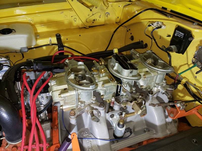

Not that I can think of, but here's some more pix:

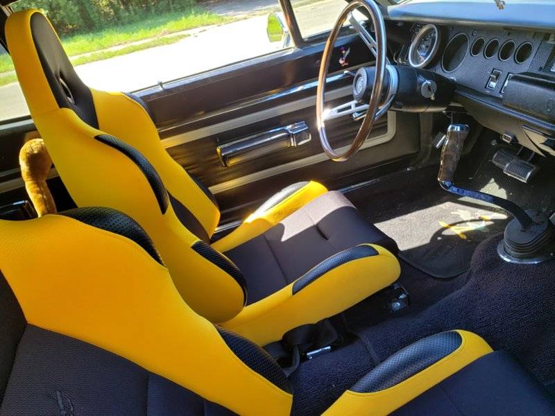

New Scat Procar bucket seats!
She sounds sweet too!
And I beat the crap out of it at the race track too!
Sure does sound good.:thumbsup:
Beautiful ride!
