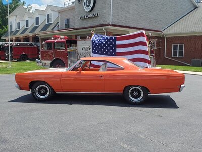

I have a 340 from a 72 Duster that was in my 68 Satellite, it was bone stock with factory manifolds.
The engine is being rebuilt by Brian Roche, he's stroking it to a 383.
What headers should I run? I've looked at Doug's, TTI, Doug Thorley and Hooker.
Tell me what would be the best bang for the buck
