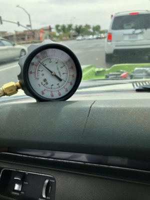

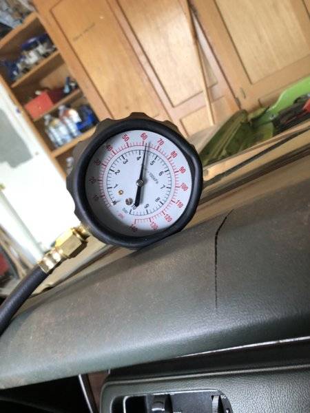

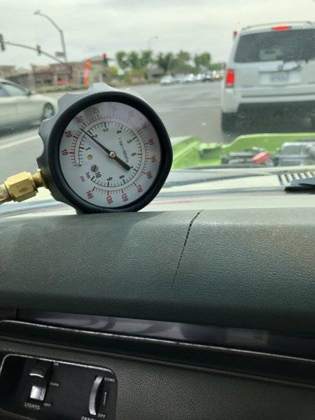

Finally was able to get a mechanical oil pressure test kit. Harbor Freight $22. I then proceeded to do a drive test as the hose was long enough to make it to my dash pad. Pressure was 62 psi cold idle in neutral cold. After warm up it came down to 26 psi hot in neutral low idle. Got about 10 psi for every 1K rpms up to about 60 psi hot.
Pics Hot Idle and Cold start Idle.
