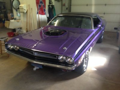

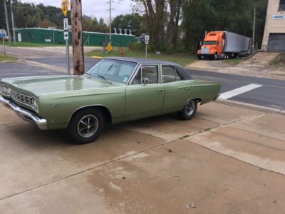

It’s going in my first mopar a 1971 challenger it’s a factory 340 non rt shaker car. I’m taking out a 511 hemi to put it in a 1968 4 door satilite I going to build a sleeper out of it and something I can drive when the weather is crappy I have other b bodies that I don’t like to dive in the rain. Looking to get 500hp+. What would be the best heads that would look stock? Thanks
The older W2s look stock. But the intake will give it away and IMO the cost is prohibitive. The other alternative is porting the factory heads which will also work, but cost a bit to get done. If you have power brakes a real 500+hp small block, like one that makes 500+ in the chassis and runs the numbers for it, won't have enough vacuum to run power brakes.
