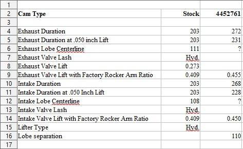

I am attaching a pic the specs I can find comparing the cam that is fitted and the stock 1978 Monaco 360 cam.
I think swapping my cam for a stock one is just about within my abilities but, before I try it, I expect a stock cam would reduce the idle noise and loping but would it also help fuel consumption to any significant degree?

I would guess that yes, you'll have a smoother idle with the stock cam and save some gas, also with your 3.31 gears unless you're running a high stall converter, a stock cam will also have quicker off-the-line acceleration - especially if you still have the original compression.

The cam is what they called back in the day, the upgraded 340 cam because of the similar lift. The reality is, IIRC, it’s duration @.050 is 228*’s. This is a street performance cam.
It should be used with headers and a dual 2-1/2 exhaust. Roughly performing in the 1800-600 rpm area. It seems you have the valve springs to match the cam. The intake manifold is an aluminum copy of the earlier 340.

You may be able to pick up a mile or two with a smaller cam. 360's were never a economy engine. A 3.31 ratio isn't optimal. A ratio in the 2.70's would be better.

The MP 0.050" cam specs for all of their cams are BS. This cam would probably measure 218/221 @ 0.050" based on other MP cams that I have mesured. It only has 50 degrees overlap. I would characterize this as a nice upgrade from the factory cam but still relatively mild.
