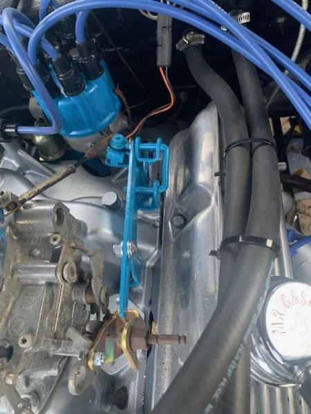

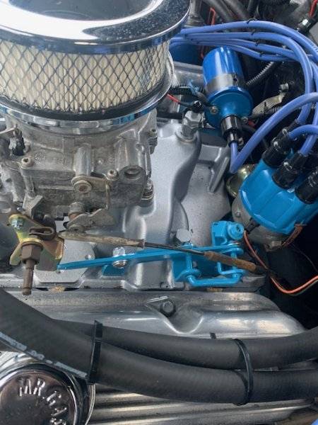

I dropped a 360 4 barrel in my 65 Belvedere wagon. The stock 273 2 barrel throttle cable is too short. Does anyone have a part number for the correct cable I should be using? Also I used the cable brackets from a 318 4 barrel and it doesn't line up very well. The Edelbrock carb seems too wide.

Playing around with it more it looks like the throttle cable would be long enough with the correct bracket. It's a late 70s 360 with an Edelbrock carb and chrysler linkage adaptor.

You do know that the cable has to be clamped under that clamp and nut thing. Right?
Looks like you have a 318 2 barrell bracket assembly. And the kickdown linkage has a lot of angle on it...

Here's what worked. The Rick Eberg small block cable bracket. It has the tab for the Lokar trans kickdown. I found out the 65 B-body 383 4 barrel cable is 2" longer than my stock one. That did the trick. I can take pics if anyone wants.

The stock cable was too short for that bracket.
