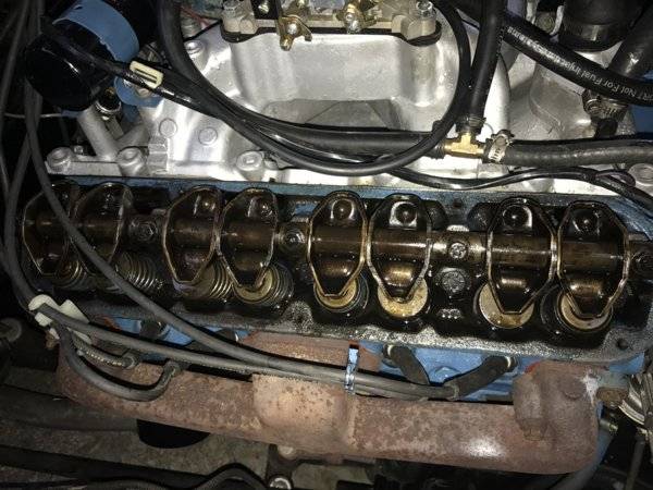

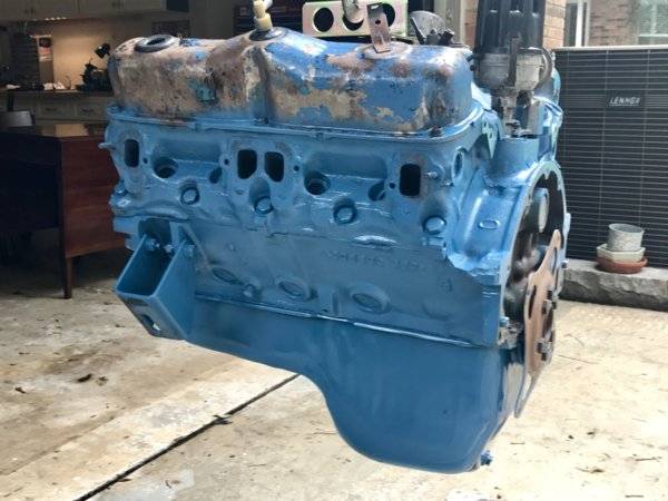

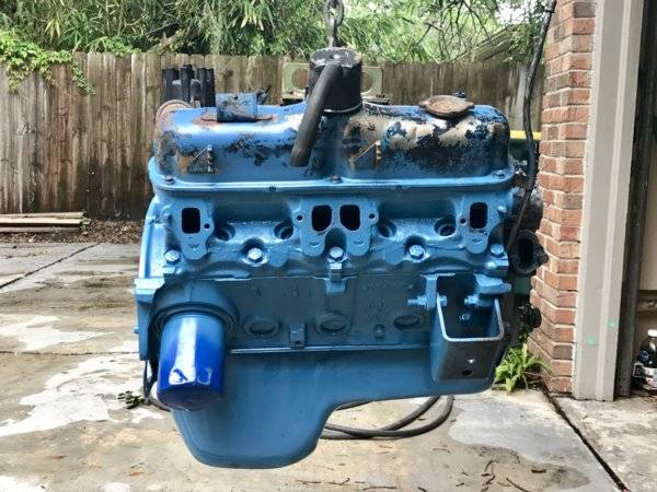

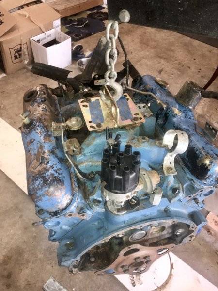

l don’t have any info on it. That’s what l was told. And that it came out of a ‘78 Karry-van. Here’s a few pics. Notice the tiny exhaust ports. lntake openings are small too.

If you could read the head casting numbers it would tell which heads they are. Should be on the head under the valve cover/rocker gear. As mentioned, if they are the 308 heads, they are supposed to be pretty good.
Yes those are either #302 or the #308 "swirl port" casting heads. You can tell by the plugged air ports below the exhaust ports. They have a closed heart shaped chamber and good flowing ports for a factory head. I wouldn't change them.
Ps, the 74 J heads are small valve open chamber.
