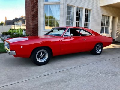

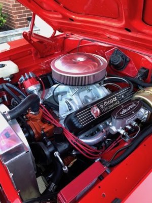

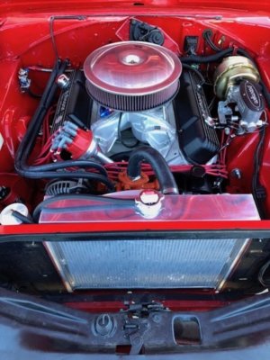

I am loving the transition to nasty big block! But... What the hell do you guys do to reduce the amount of engine heat getting into passenger compartment?!? Please share any tips.
You can put insulation on the firewall, wrap the exhaust under the car.
I saw your FB post, but the only real fix is quality dynamat or sound/heat barrier mat. Big headers mean big heat! lol
Is the heater box closed off? That may be adding to the heat?
Perhaps try adjusting the heater box flaps. Those headers will supply enough heat anyway.
