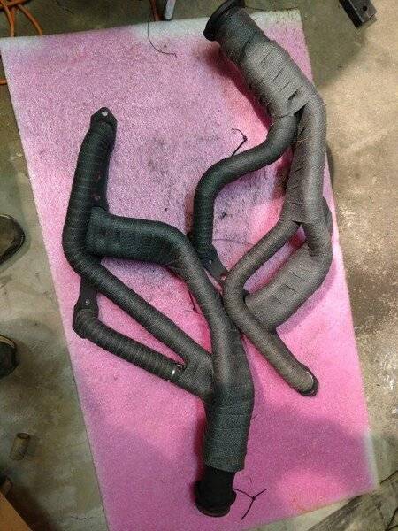

Exhaust Heddman Hedder B-RB Shorty style 1.750 inc tubes with 2-5 inc collectors hed-78070_xl.jpg
otherwise, they damn near drop-in' & it's easy to get at/change plugs etc.
I'd highly suggest DEI socks so no problems with getting burned
