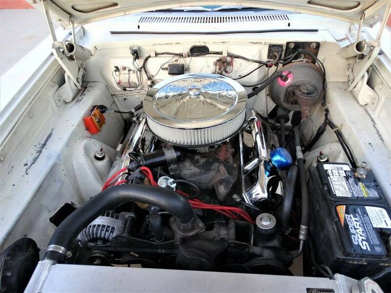

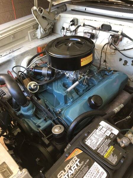

I just pulled my original 1964 361 and installed a 1970 383.
I started by installing a Edelbrock Performer intake with a Edelbrock 650 carb. The previous owner had already installed a 500 cfm 2 barrel Holley with an adapter and it ran well. He also installed electronic ignition and dual exhaust and added a shift kit in the original push button. He also changed out the 3.23 open differential to a 3.55 open and had the trunnion style drive shaft by adding stub shafts to run regular universals.
The car was fast IMO, it would put you back in your seat fast and when manually shifted it would pull the rear of the car to the right.
The reason I made the change was because the guides and seals on the 516 heads were shot. I could have had them rebuilt but I was able to purchase a very low mileage 1970 383 HP with a very fresh set of 516 heads with the larger 1.74 exhaust valves and mild porting and gasket matched for a few hundred more than it would have cost me to do just the heads.
The engines look the same and some of the parts on the 361 were switched over to the 383. The 3 photos posted go from how it looks now, how the 361 looked after the update and then the 361 as it was when I received it.
383
361 updated
361 as received
Of course the 516 heads, upgraded to the 1.74 ex valves, is a big help. My advice of course is basic pocket porting the 516's with the 1.74 makes them do as well as any 906's with a moderate cam and RPM.
