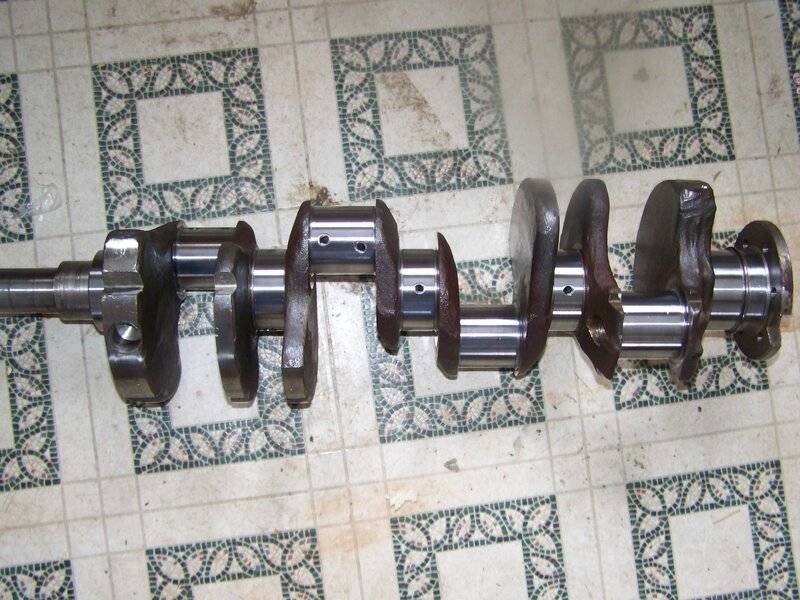

440 crank offset to 3.9 with a 2.200 BBC bearing. The crank is drill for a 4 speed.Main are low block std. $425.00 + shipping and you used pay pal add 4%

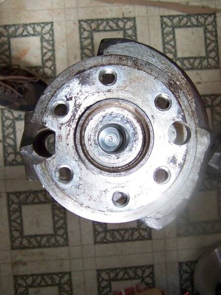

Are you sure it isn't 2.200 on the rod journals? 2.100 is sbc. It looks to be drilled for a 4-speed?
Yes. looks like you may have to still turn down the counter weights.
By using a 3/8 or 1/2 ball grinder and clearance the block the crank will work. I been doing this for 15+ year. I'm sure someone will say this will not work. Maybe I should add photos so people can see this step. I thinking of building a 383 with the crank with a 4.310 bore so looking it 455 CID. Used my 67 Bel 1 and a 727 a set of 915 head stock ports 2.140 intake an 1,710 ex valve cam with .445 lift flat top piston. The cam is a old grind from a H/S car 343 HP cam. The intake will be a 57 Dodge/Ply dual four with the old carb. Looking to run 11:20/11:30

How many cubes would this crank give me on a stock bore 383?
Ross piston 99170 Summit stocks the piston and a 6.7 BBC rod. 1.95+1.307+6.7=9.957. 383/400 are 9.980 CH
