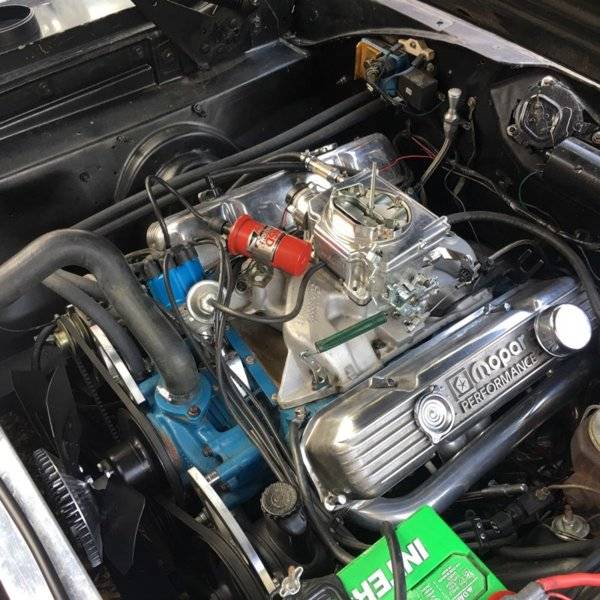

I saw a member's 72 400 slapstick SSP with Summit/Flowtechs.
The shop that installed them said they did not do any mods.
I only saw from the top, but did not see any dings.
They do come with a factory flat spot to help clear a power steering pump.
I just bought a pair for myself but have only just started to test fit them.
