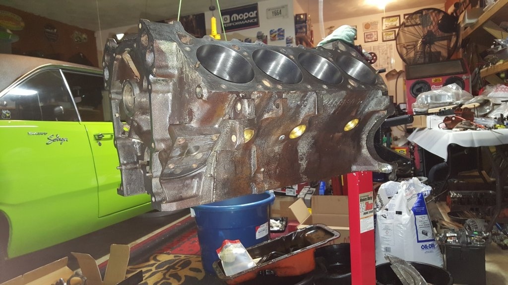

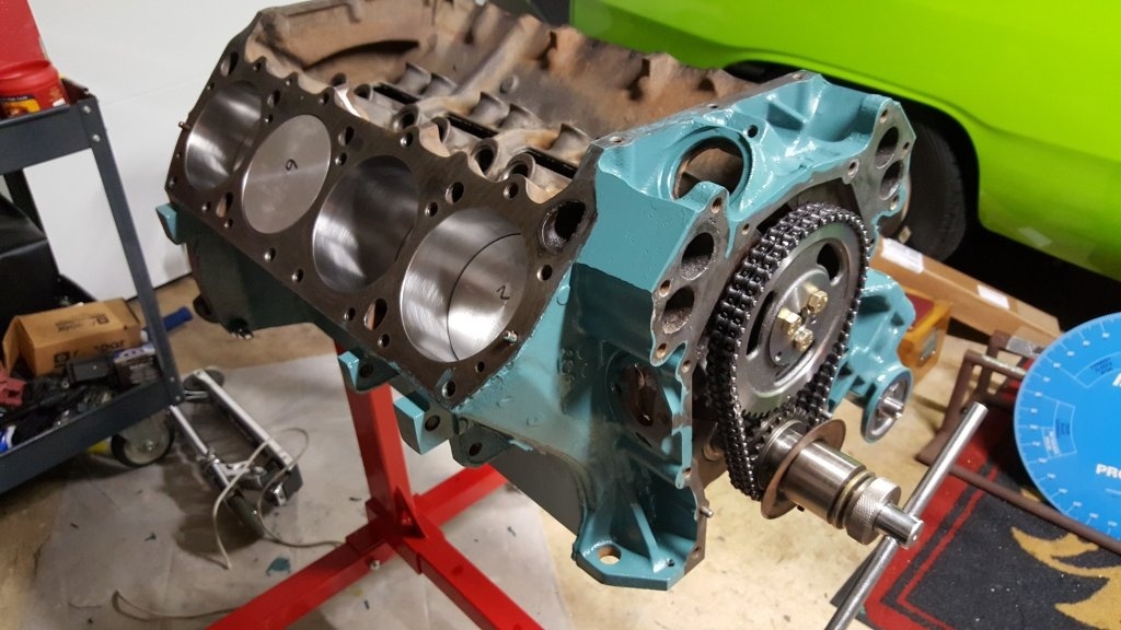

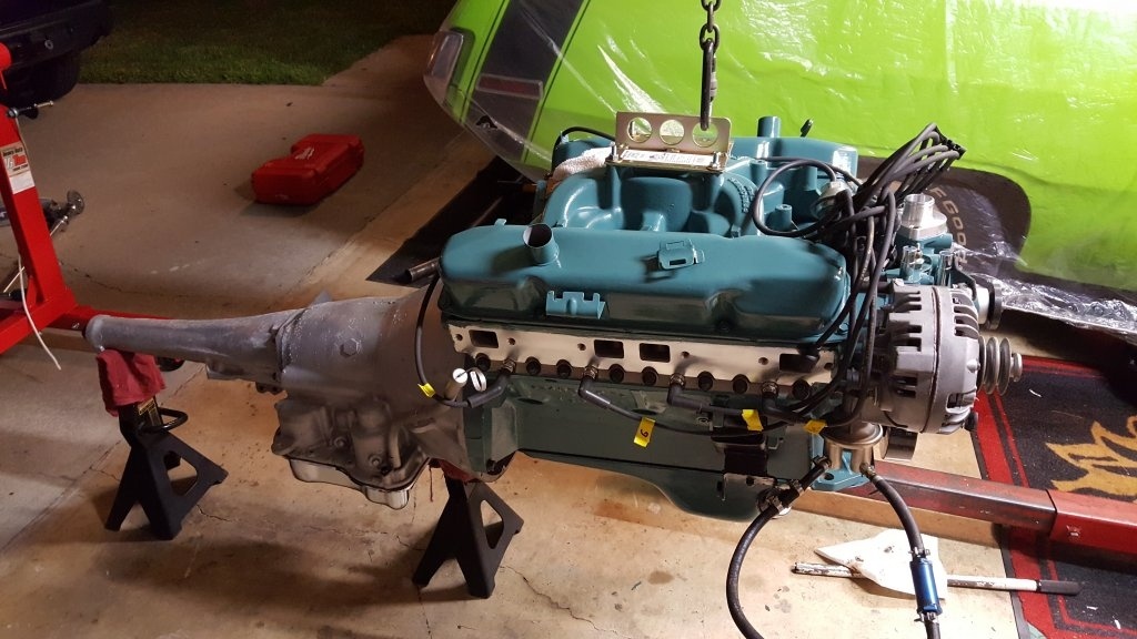

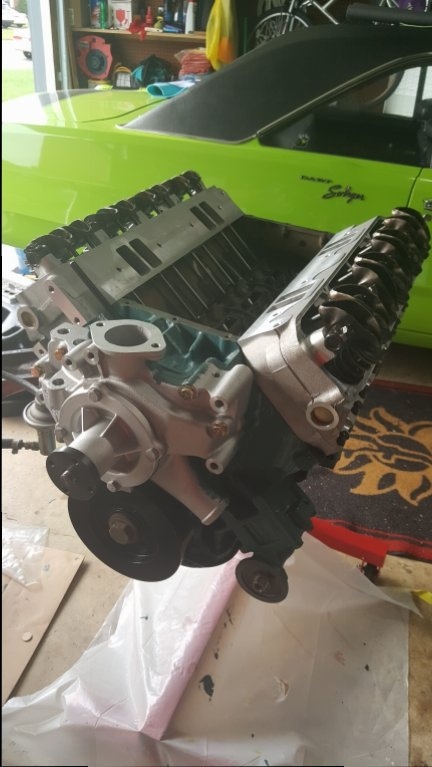

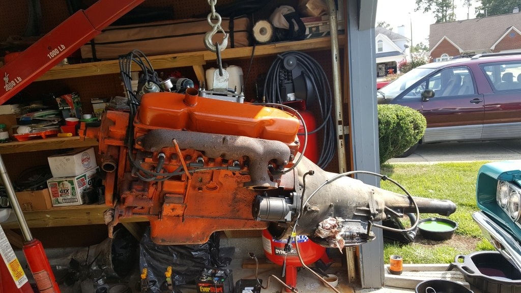

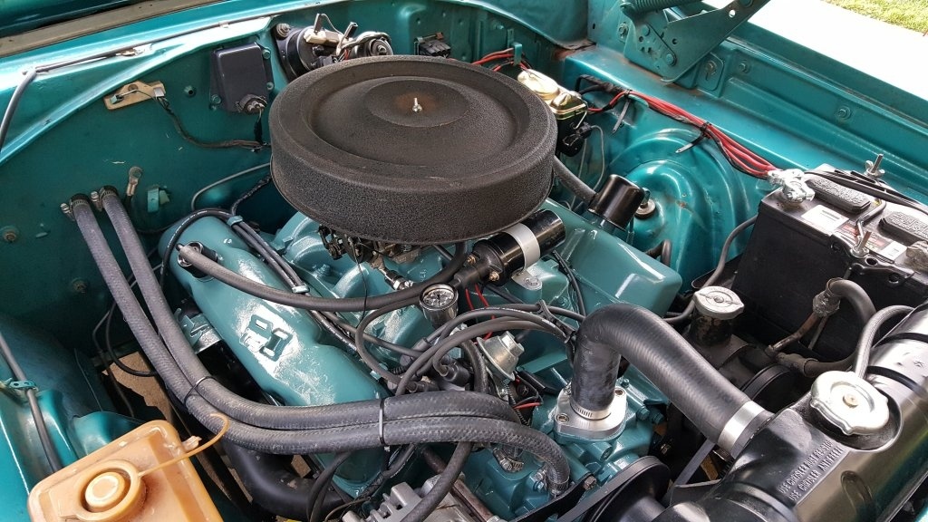

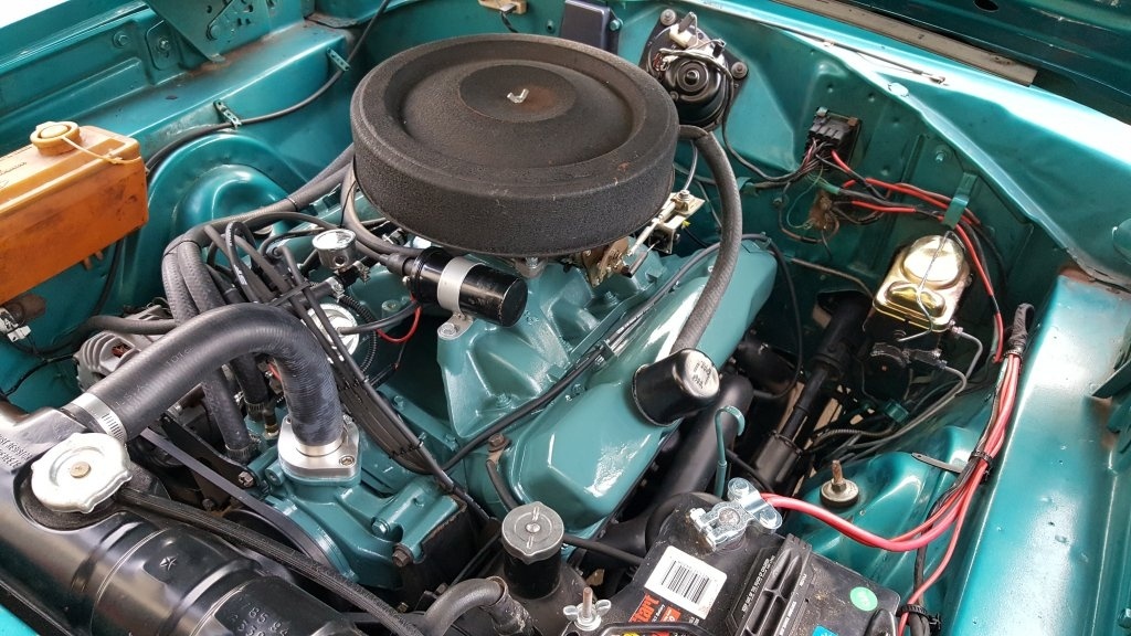

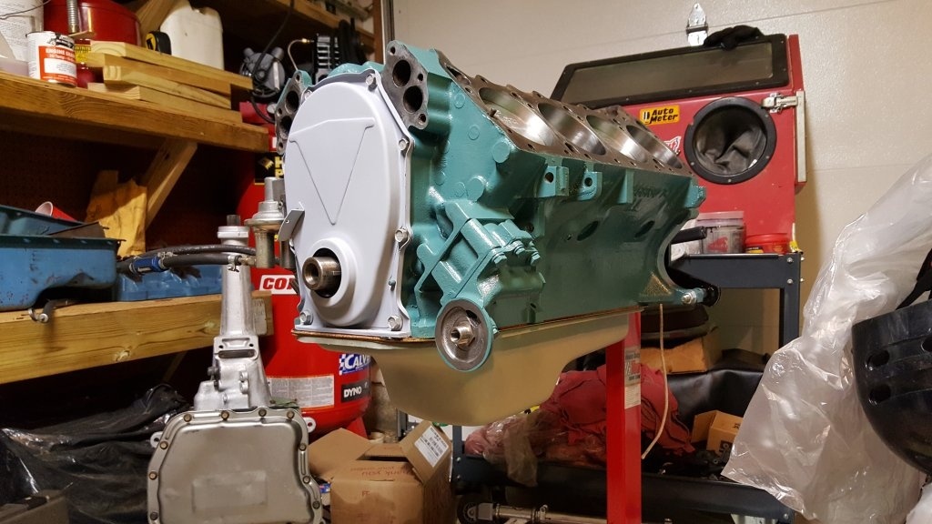

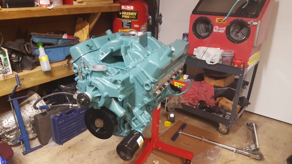

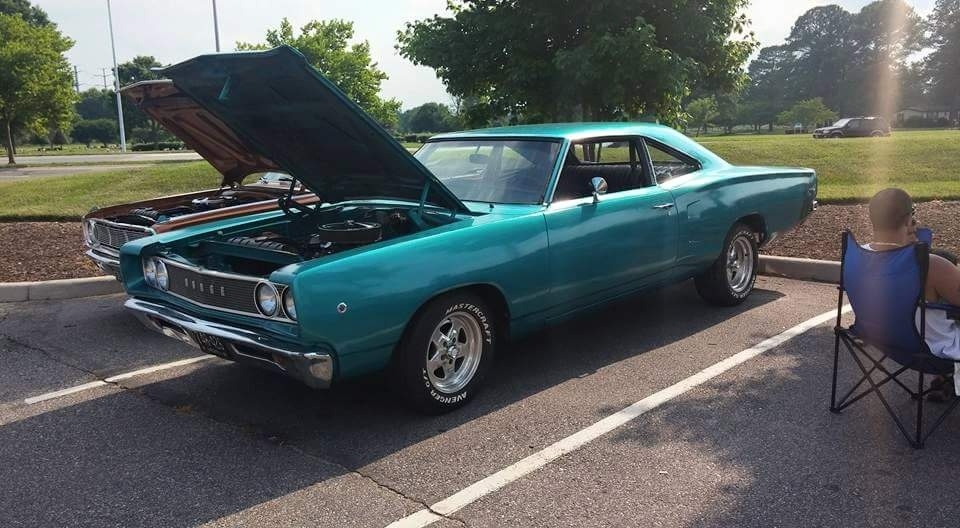

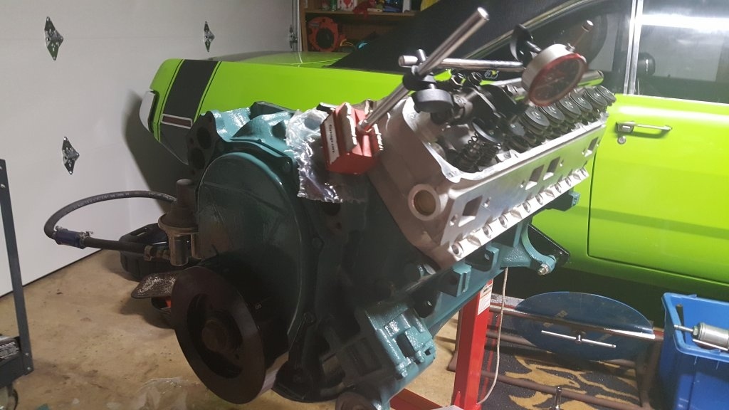

Pulled the tired 383/727 out of my '68 coronet last month. Trans was rebuilt. I built the motor after machine work. .030 over, stealth aluminum heads, eddy rpm manifold, eddy 800 avs, aluminum pump housing and pump. Comp cams 477/481....9.44:1 static compression, 7.75 dymamic .. Got the engine in last week, fired it up and broke in the cam today. Was fun but glad it's over !!

I really like the stealth stock look of the engine. :thumbsup:

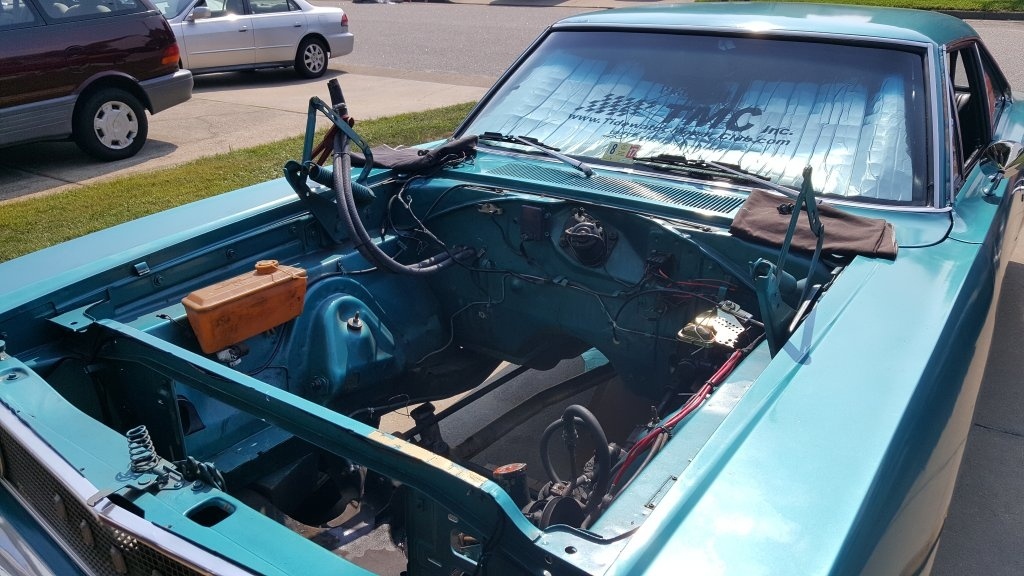

However, that washer bottle has got to go.
Oh it runs good, Real good ! The housing is from summit, it's by canton. $60 .... looked so nice I decided to leave it the only thing bare !
