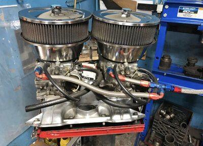

At present I have a single plane Indy intake with a 950 double pumper Holley carb. I thought two 625’s would pump much more air and fuel. Is that backwards?
You are headed down the wrong track. What "high rise" dual quad manifold are you talking about? A tunnel ram?
I have the same manifold. At one time, I was considering a 400 stroker...
I do not know much about it. It is not a tunnel Ram.

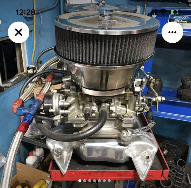

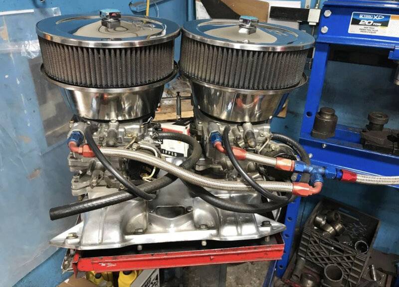

This is it.
E378108C-C5D1-4763-956F-2762FDDB0C76.jpeg 3113A649-B877-41E8-97DD-ADC328093347.jpeg
We use that manifold with decent result on Eddy heads. It is definitely not the intake you want to use with Indy heads. If you are looking for an intake with 2 carbs you have 6 options. Custom fabricated tunnel ram, Indy tunnel ram, Indy 440-25 cross ram, Indy Mod Man, newer Chrysler cross ram, original Max wedge cross ram.
