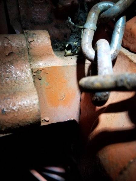

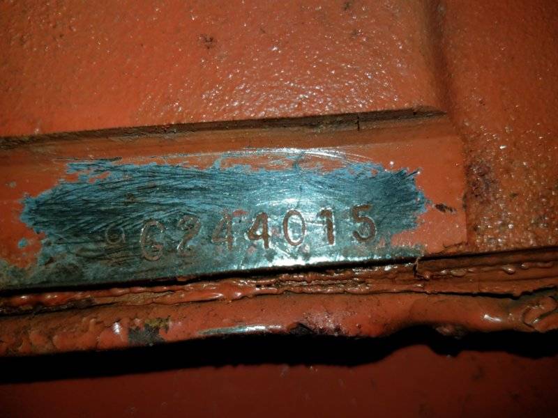

This engine is in our 1969 Super Bee project. See the pic. It is very hard to see what the number is left of the G. It is not the original for the car. If this belongs to someone's car, please let me know.
A couple of ways to help determine the year of the car the engine came out if....look on the pad by the distributor or the casting date of the block.
It will be easier once we know the year.

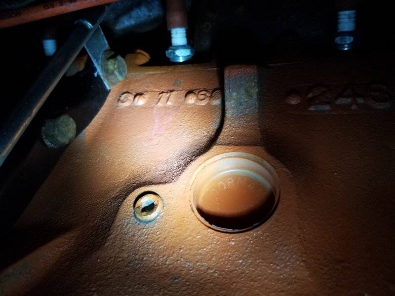

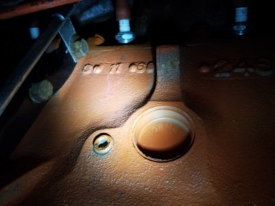

Staring some more at your little picture it may be A9... rub some paint off.. Looks like a November 68 block casting, so that would make sense.

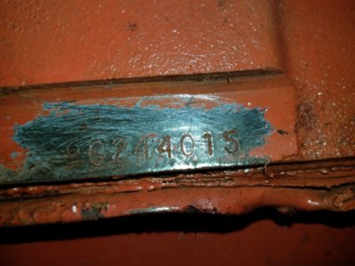

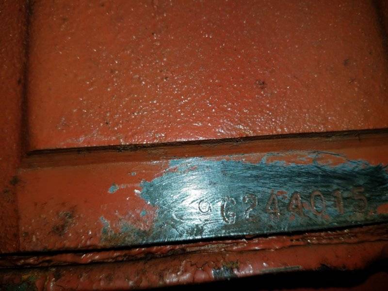

Another commercial break...looks like 9G244015 with a casting date of 3/11/69

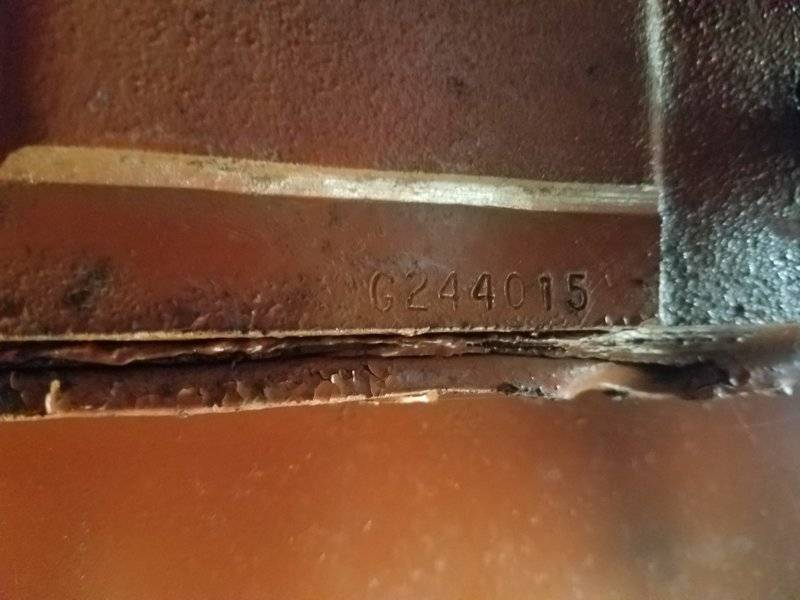

I can get this close.
WM23H9G243990
****H9G244015
XS29L9G244034
SPD 401 (April Fools Day)
Looks like it was out of a Coronet (W*) or Charger (XP) car. Does the pad show the HP stamp?
