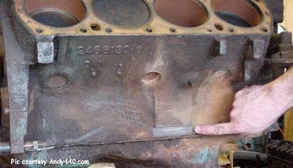

IIRC "general consensus" is that early (maybe first half year) 1968 blocks got NO VIN stamp.
...and as you can see, the bellhousing location stamps were crude.
They got their act together for 1969 production and later.

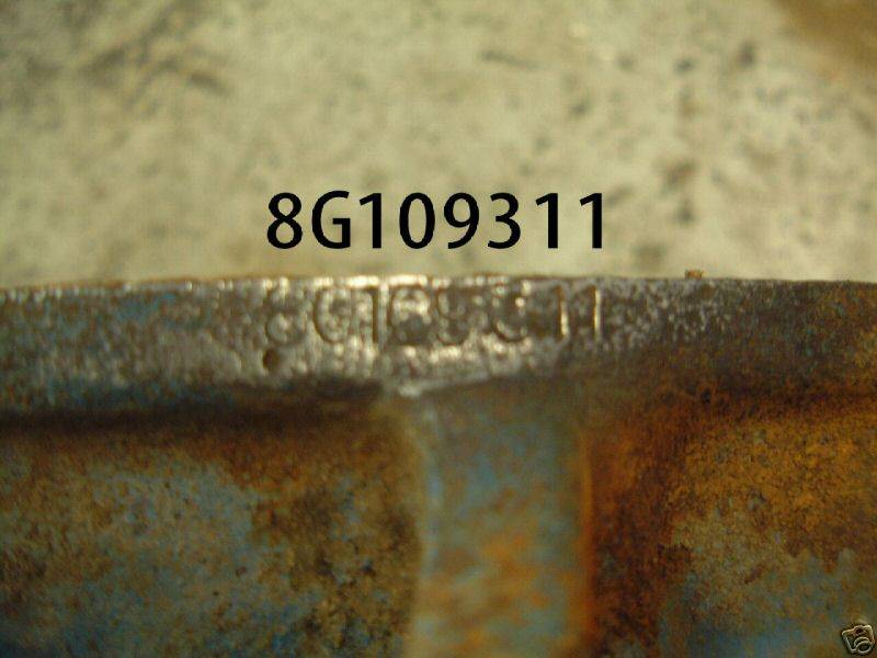

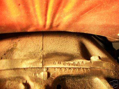

Spotty research indicates that VIN stampings varied by plant and 'general consensus' is wrong. Here's an early StL stamping indicating they were stamping VINs in August.
Some plants seem to have started earlier than others so it's difficult to make general statements about the stampings..
This is a topic that needs more research.
mine was from st. louis plant built in march , no numbers on top of back of block
Yup. Seems every 'resource' I have checked has different/inconsistent info regarding stamping and numbers.
