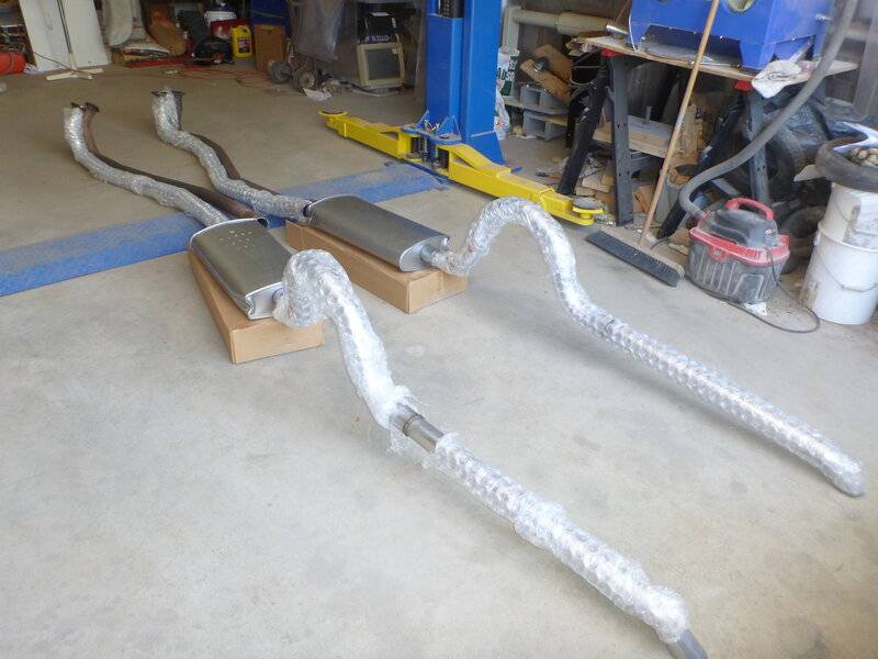

Tailpipes 2 1/4". I let Dave Walden at ECS use my 383 OE headpipes to make their jig set up, to reproduce them exactly.
